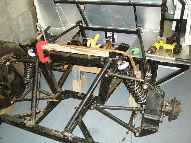

Hi all,
I'm in the process of converting my Tornado chassis from Rover to Ford 302 engine. Having cut out the original engine mounts, the limiting factor on how far the engine can be lowered into the chassis is the two cross-members under the gearbox.
I'm considering cutting them out and then welding back a piece of 1"x2" tube below the tubes I've cut out to retain the stiffness. This would allow the gearbox to sit a further 1.5" lower, whilst retaining a reasonable angle on the CV joints
Has anyone done this mod before and more importantly, have I forgotten anything that I should be considering??
I've attached a currrent photo to try and explain this gibberish
Regards
Andy:confused:

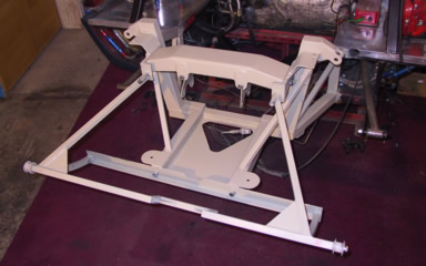

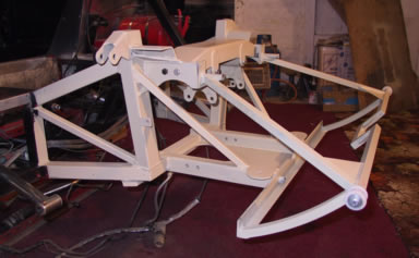

Frank Catt of Wealden Engineering Wealden Engineering Development has done a similar modification to the GTD chassis. Due to the similarity in the chasiss designs why not see if you could splice one of Frank's rear sections onto the Tornado chassis to take advantage of all his refinements?
You will see in the attached photos that Frank, in his modifications, notches the rear horseshoe to allow the engine to sit lower.
