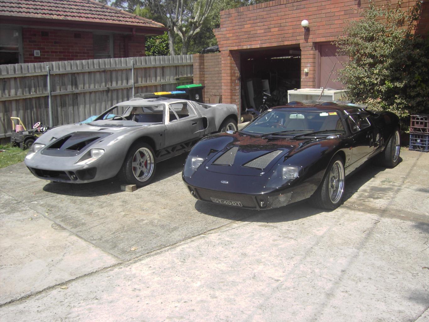

Hi All
This is how I fitted my tow hooks which still allow the front clip to be opened.
I have had the car towed onto a flatbed tow truck several times during construction to have various things done with out any problems.
I also have the same tow hooks at the rear.
I made some chassis extensions which sit behind the two openings and ar very heavy dutyand even allow the car to be jacked up by the hooks.

Apologies for thread drift, but had to comment. Just love that rad exit mesh look Dimi! Not seen that solution before. It looks elegant mate.. :)
