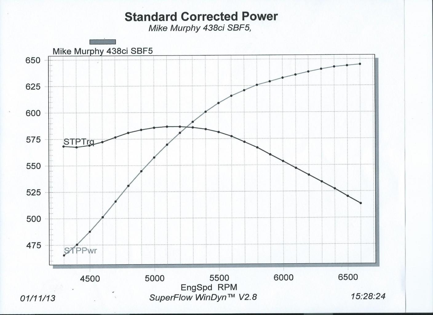

I have to agree with Ron on this one. I wasn't going to vintage race so I wanted the most I could get and let the right foot control it. I also went back and forth on 302-331 and 351-427, I ended up with a 351-438 recommended by Olthoff. Dennis did the install and I received my car about 6 weeks ago. It is scary fast when you put the pedal to the floor in 1st, 2nd, and 3rd and 4th just pin you in the seat and that is exactly what I wanted. One thing different on the throttle for me is the travel on the pedal seems like it goes on forever so it is real easy to roll onto the throttle, it seems like forever before it hits the floor.
I went with a dry sump setup with solid rollers and Jessel shaft mount rockers. Motor is good to 7000 rpm but I set the rev limit at 6500. After the first 500 miles, I adjusted the lifters in about 1 hour, real easy job if you don't mind pulling valve covers and turning over the motor. I will check again in another 500 miles just for peace of mind but I don't think I will see any adjustment needed. I have attached another dyno sheet for you to look at. Like Ron, I wanted a motor that wasn't pushed to its limit but still put +550 Hp and Tq.

Ok. Finally.
The different lines represent changes following tuning the Webers.
393W running something like 11.9:1, AFR 205, full roller, solid lifter, wet sump, Weber 48s (rejetted with venturies 2 mm larger than stock), 110 Sunoco (needs 100 octane).
**Nevermind that it says FE on the bottom of the sheet, thats what this builder is known for, and typically dynos. He forgot to change it.
