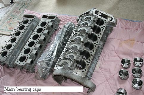

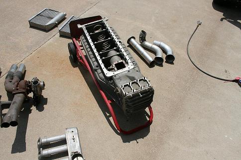

I have a extra motor and transmission complete for a LP400s, the transmission is from an late model which had ZF gears and much better. The differencial is in the oil pan but separate from the engine oil. There is a tube which goes through the oil sump so the drive shaft from the transmission connects to the differencial.
Your only two hours from me, if your ever in NW Arkansas, give me a shout you can measure anything you want.
