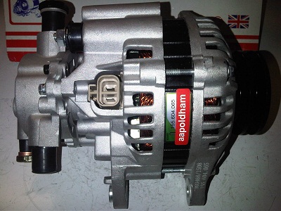

Larry L.
hello, other decent solution is to find the combination of alternator/vacuum pump which can be find onthe nissan petrol diesel 4x4 some mutshibusi diesel engine equipped 4x4
thats the way i'm going in my build
as example:MITSUBISHI L200 2.5 4D56 TD DIESEL BRAND NEW ALTERNATOR + VAC PUMP 1998-2006 | eBay
hope this could help
