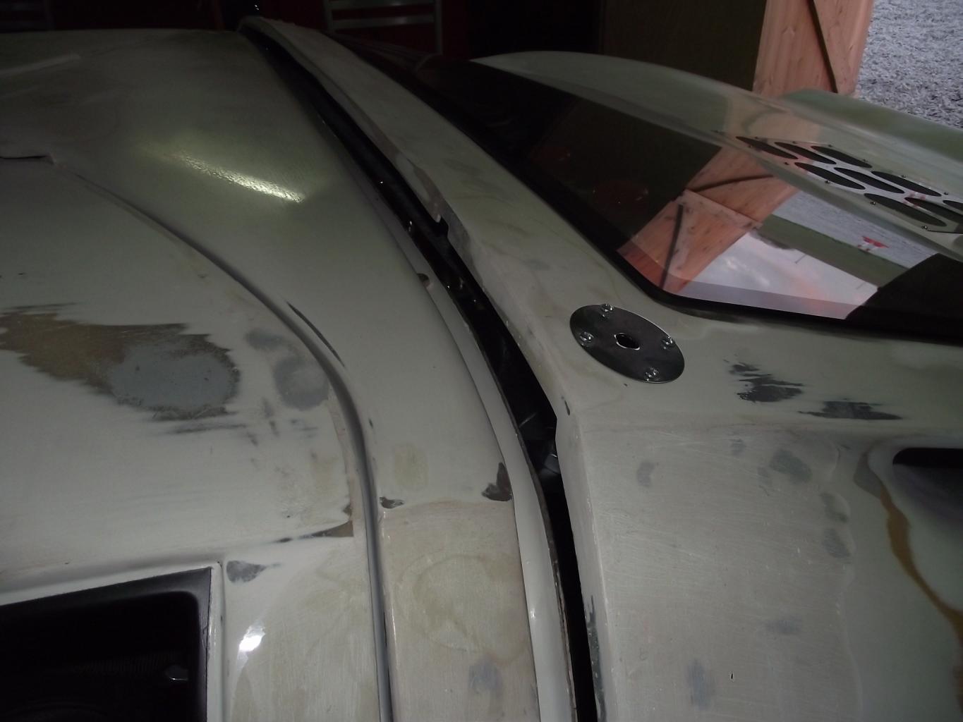

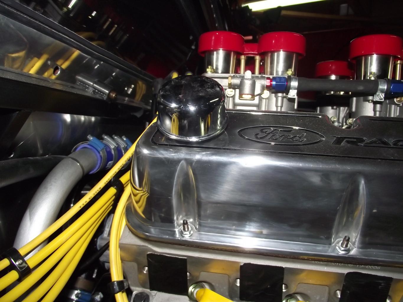

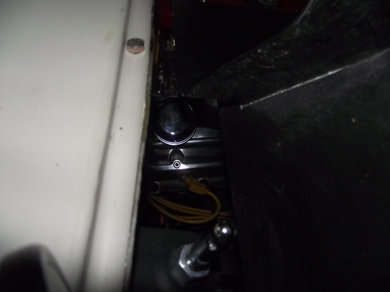

Here's a photo of my problem. I have push in breather vents and the size of the vent plus the valve cover means that the rear clip cannot close properly. The rear breather pushes up on the rear apron, and the furthest forward breather interferes with the underslung section of the rear clip?
I have searched for a smaller push in breather but so far no luck. Mine is around 35mm deep but I need significantly shallower. In the worst case I could replace the valve cover with a shallower one, but I dont want to go that route if I can help it.
Another option is to replace the breathers with caps, but that means no venting!
Any suggestions to my dilema greatly received.

Have you tried flipping the valve covers to the opposing sides putting the vents in the front of the engine rather than the rear?
It looks like you have the type of breather that pushes into a rubber grommet. I would look into using an angle fitting of some sort to connect a hose which you can then route to a breather tank. There are numerous solutions, just need to find the one that looks good to you and works well for your engine.

The second choice, looking at your pics it is hard to tell but you might need to drop your engine an inch or two. Looks like it is sitting high compared to my two pics, and is it sitting with the front of the engine high? If so it needs to be flattened out by using shorter front engine mounts. That might give you the distance you need. May just be a conceptual thing. Hard to tell.
That’s option occurred to me but the rear deck is already sprayed black as the rear glass is fitted. To fit a bulge, I'd have to respray the rear panel with the glass in place and that could be difficult to get a good paint finish later. I think maybe the remote catch can is the way to go.

How about a different set of rocker covers?
Perhaps the "Cobra" ones which are less square and would thus allow the filler to be positioned at a different angle
I have finally decided to change the rocker cover instead of an oil catch can. I have the "tall" type rocker cover which is too big for the engine bay. Andy at Tornado is fabricating another batch of Gurney covers, so I'm ordering a set of these.
