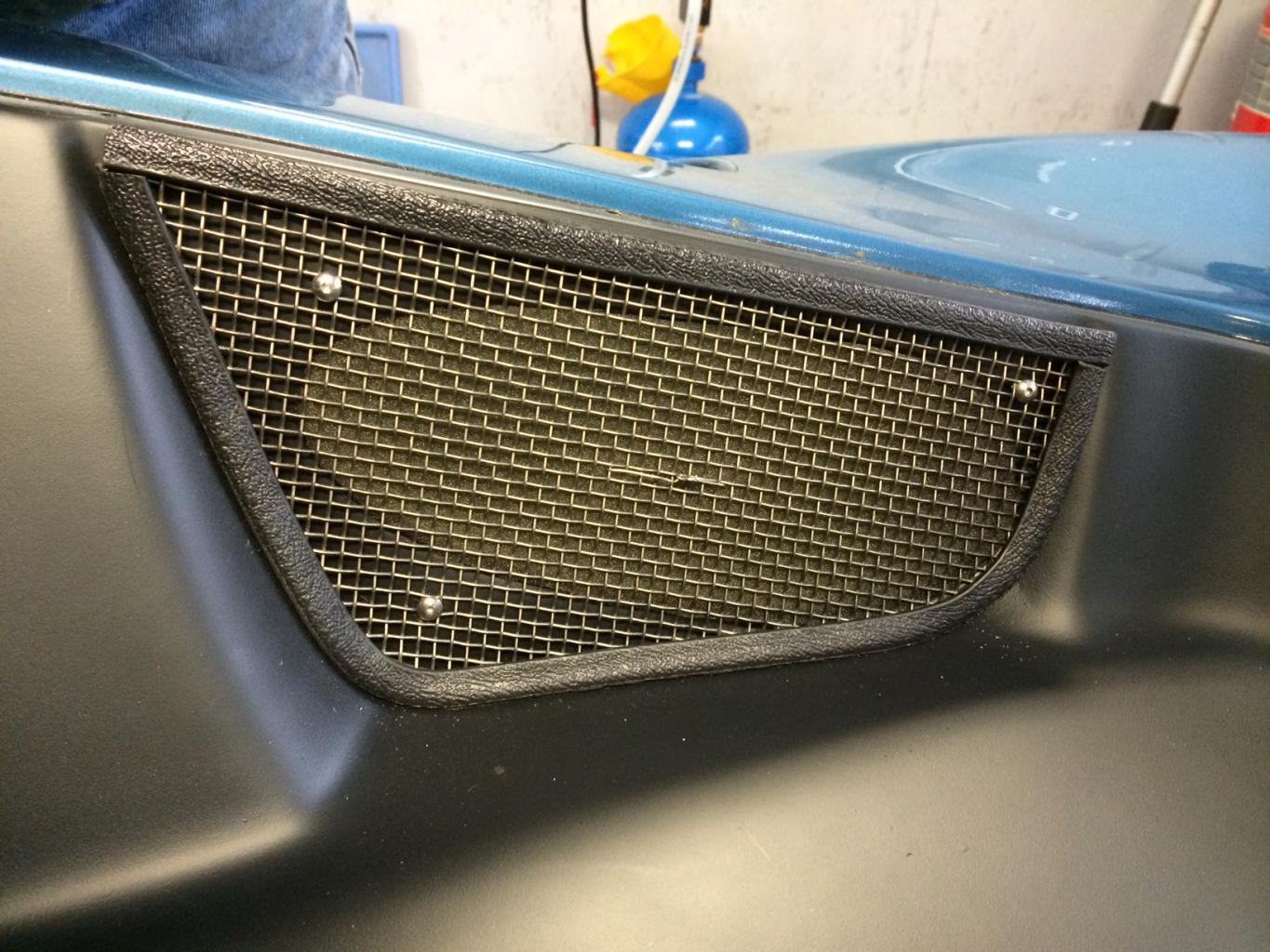

For all my grill work I used McMaster Carr McMaster-Carr
"9319T118" 316 stainless that is a 4x4 mesh with .047 wire size with a .2 opening.
This is fairly thick but will stand up to any stones that come your way. I have this in the front of the nose of the car and is held down with some button head sheet metal screws and small washers into some fiberglass putty added to the border area.
The rest of the vents will get the same size mesh. They will be formed to fit in the opening from the back sides and held in place with screws hidden behind them. The air vents in the rear tray area will get some similar to these.

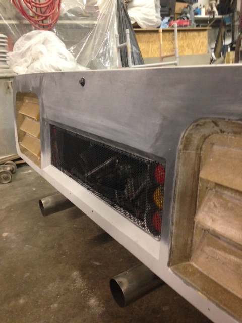

No photo at this time, but I use black powdercoated hexagon aluminum mesh I purchased on Ebay. Cuts very easy, and the holes are perfect for 1/4" screws (or body panel plastic fasteners) to hold it in place.
That looks like the stuff I use. Really like it.
I did some research into the air flow for mine (looks a lot like yours) and it was good to go. There are some that are restrictive, but not this particular pattern. At least, not the stuff I bought which although didn't come from eBay, looks a lot like yours.
