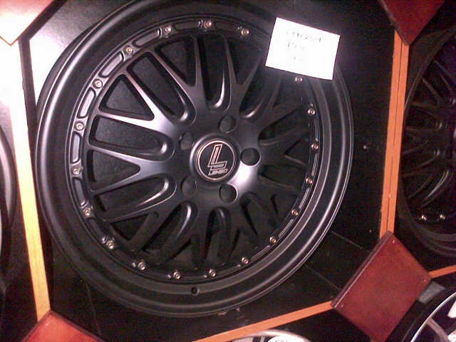

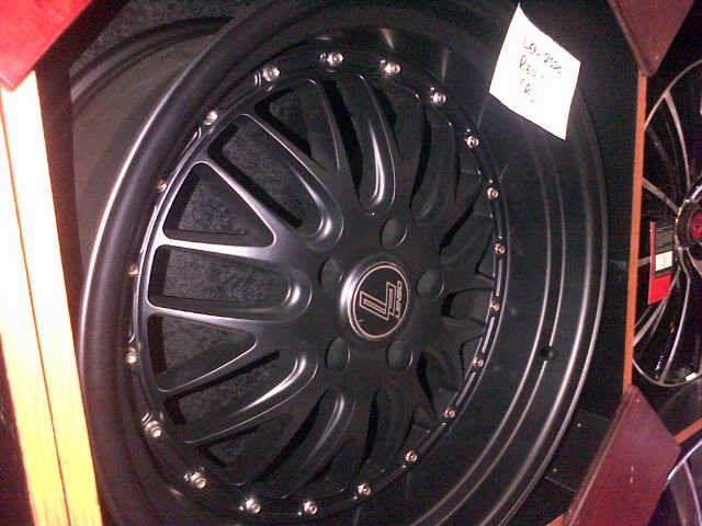

I might go for these Lenzo rims. Rears are 19" x 10.5" and front 19" x 9.5
They cost R10000 Which is about $1100. What do you guys think?

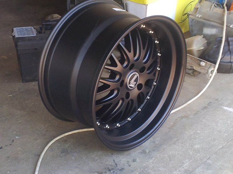

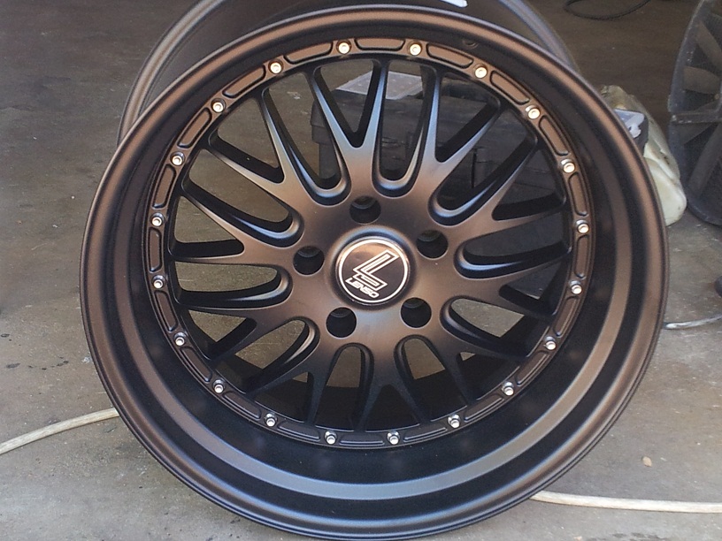

Here's pics of the rear rims.
