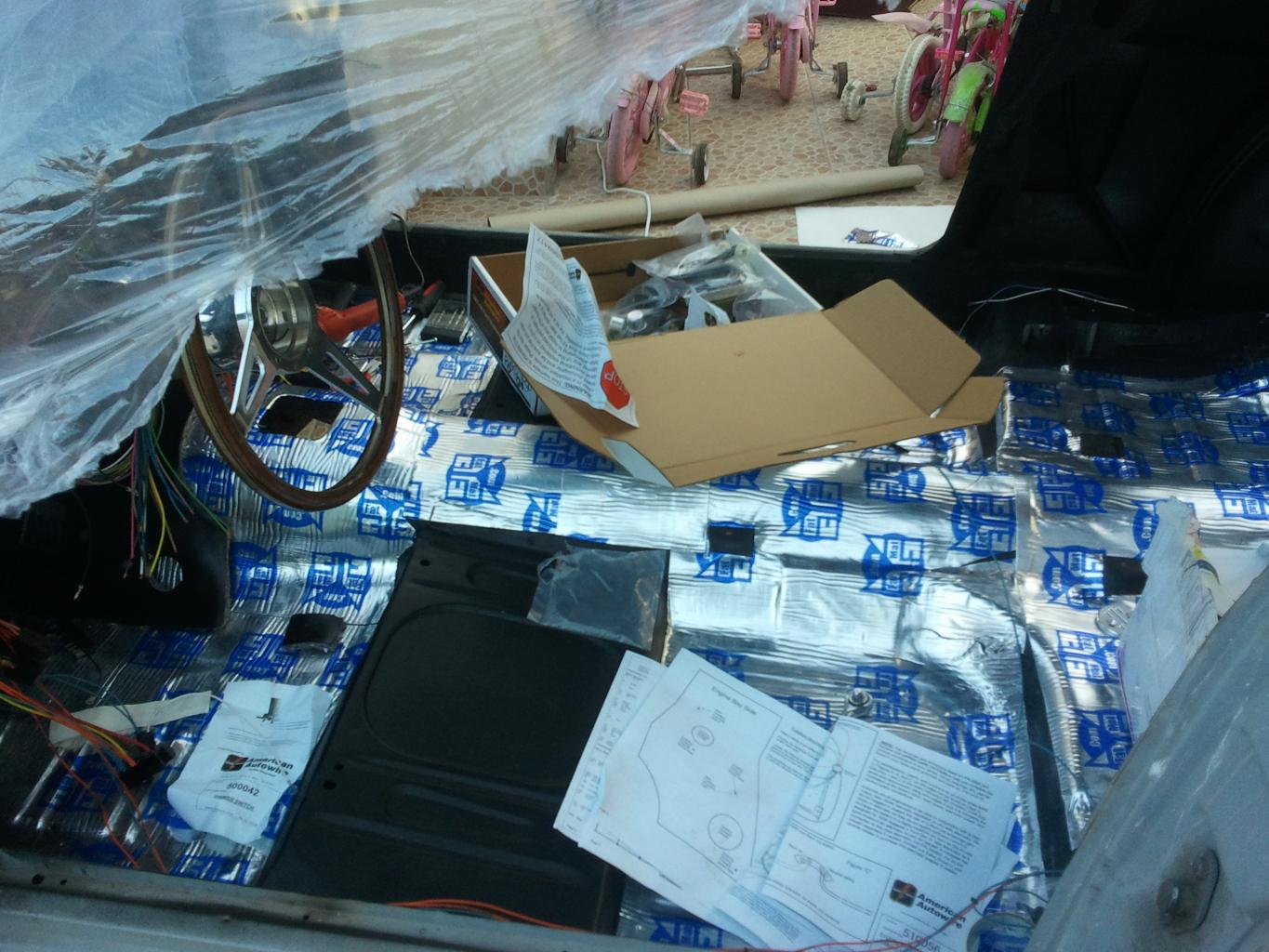

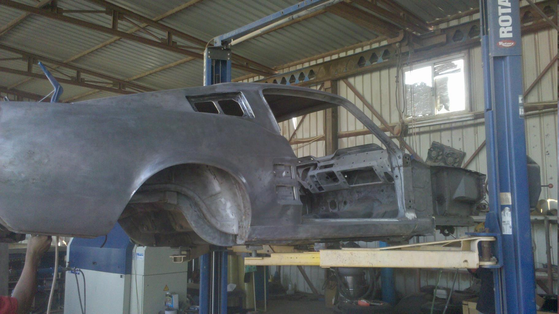

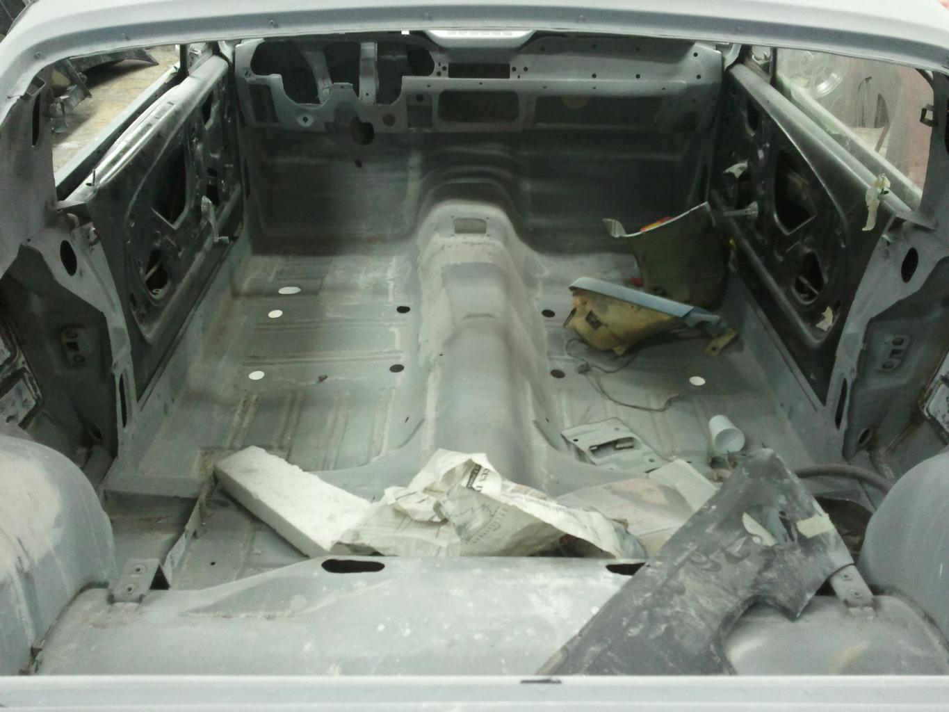

Ryan and did exactly that. 1965 mustang starting with a fastback "shell".
Took ten months of fairly intense work. Did all the work ourselves except the final paint and the engine. You should be able to easily do it for the prices estimated if you get some parts from a donor, although we used mostly new parts.

i did the same few years back , but i used a 67 mustang fastback
it took me 18 months or so i cant remember
i would not requirement starting with a daynacorn shell , because you will need to buy all the parts new , depending on what kind of a mustang you want parts including the engine could cost from 40K to 100K .
i would suggest that you find a rust free 67 or 68 fastback with a title and use some of the parts like the rear glass , windshield door windows, interior . 9" rearend.
replace the suspension upgrade the brakes engine and tranny .
believe me , been there done that , you will save a lot .
and the most important thing is that you still own an original fastback with a fastback title ,not some newly produced shell with no vin ..
