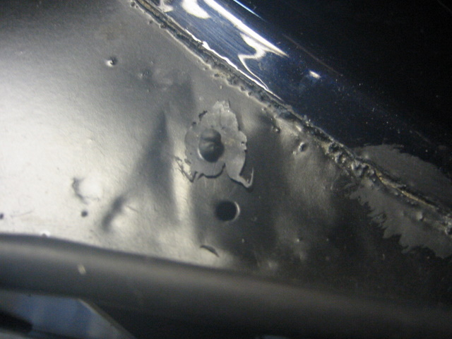

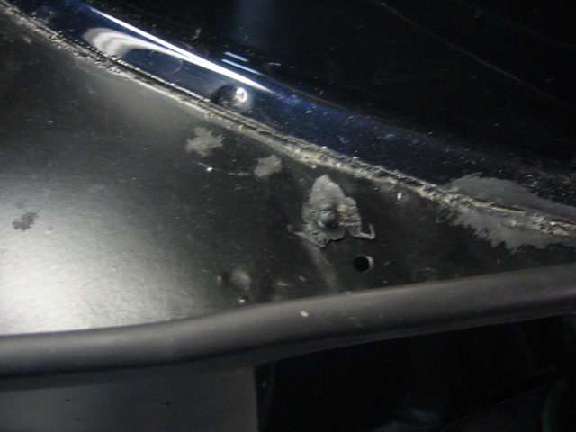

In my never ending search for finding water issues with my GT40 I found something interesting. On the cowl about 6” back from the gas caps I found a spot of black silicon caulk. Not knowing how to leave well enough alone I started digging at it. Well out popped this piece of caulk and below it was a 1/8” hole right where you might think someone would put a water drain. It turns out that on the original GT40 road cars there was a couple of drain in that area, one just about where I found the one on my car. I’m not sure about the race cars, I really don’t think they cared about water drainage.

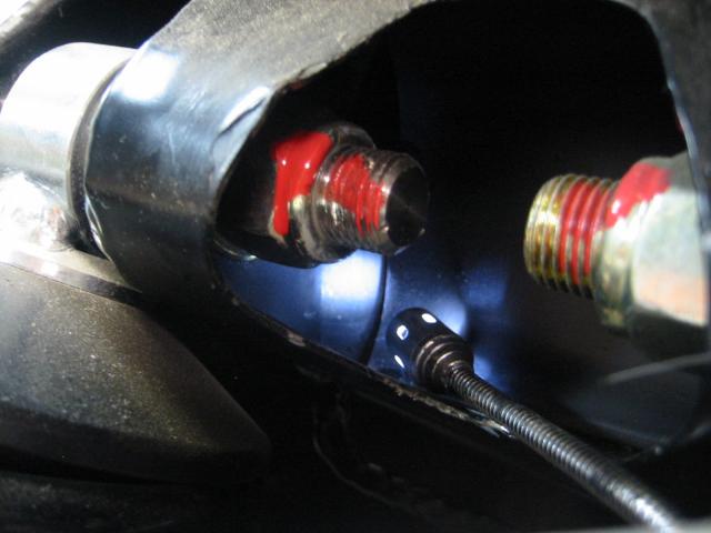

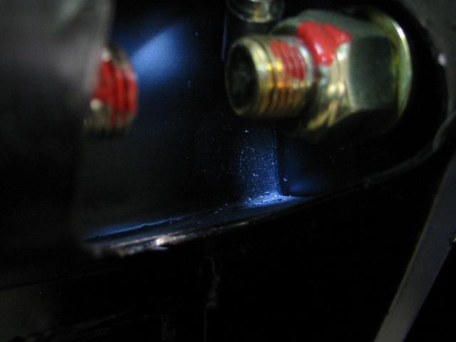

Well at any rate I’m going to make it bigger and add some plumbing, I might even add a couple more. You might want to have a look at where the front suspension mounts to the car. In back of a few of them you’ll find some good sized holes into the chassis. Not that I'm looking.

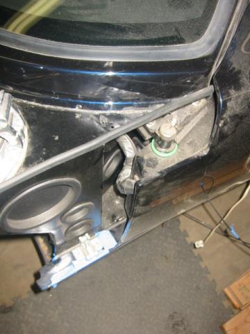

Did I miss something, why is it I can’t edit my posts any more? Well anyway there was one more picture I wanted to add.

Richard when you find all the leaks please let us all know, I have thought the same as you that this area would be a good place to have a drain. The naca duct in the center of the front clip feeds water by the gallons into that swimming pool area. Also the fresh air naca duct feeds water straight into the blower unit. I bought some of the pipe insulation that they use to keep house pipes from freezing and used it to seal between the fender well and that area as Randy suggested but still have water on my legs. Something (many things) have to be done to drain that area you have a good suggestion.

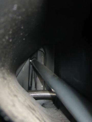

The sponsons are a prime example. If you follow the rubber seal between the bluckhead and the rear clamshell down, it just dumps the water onto the area just in front of the battery box and a similar compartment on the left hand side. There are no seals on either of the covers which allows the water to drain into both sponsons. Also take off one of the rear tires and look forward to where the lower tailing arm goes into the frame. It looks like a triangular shaped tube, in about 18" the tube just stops and opens into one of the boxes that make up the rear of the car. Any water coming off the tire going up the tube ends up in the sponson.
