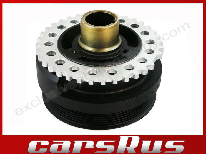

Picked up a bunch of bits from Boost (?) Engineering, which included the 35 toothed wheel for attachment to the crank.
Can anyone advise how one goes about glueing this thing to the harmonic balancer? Are there special balancers which are machined to accept this gear, or do you simply machine the balancer to accept the wheel?
Clive
I had a shoulder machined on my after market tv damper to accept the trigger wheel. 3 slots were also machined in the trigger wheel to allow final adjustment relative to the sensor. Finally held together with 3 off M6 screws loctited in place.

Lucky for me then :laugh:
Powerbond # PB1463-ST
