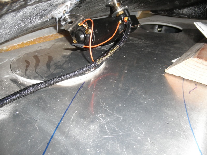

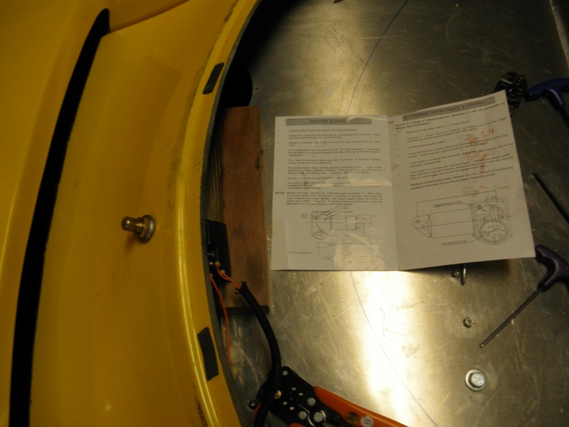

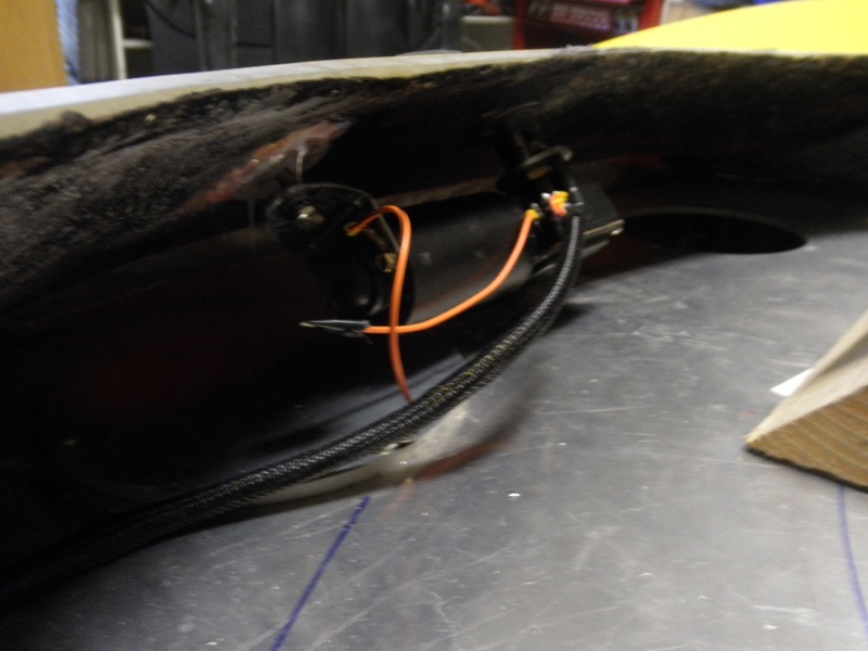

I had to notch the top of the footbox to center this wiper motor a bit. it works great, i've been stuck in the rain a few times. it is 1/2" too long but doesnt seem to bother it even with one arm across that huge angle in the glass. Fran may have changed that motor from my 2009 kit though?
Use the 0ne-inch shaft! No cutting the footbox required. AFI makes a black wiper arm that is adjustable for length too. About $14.00.
