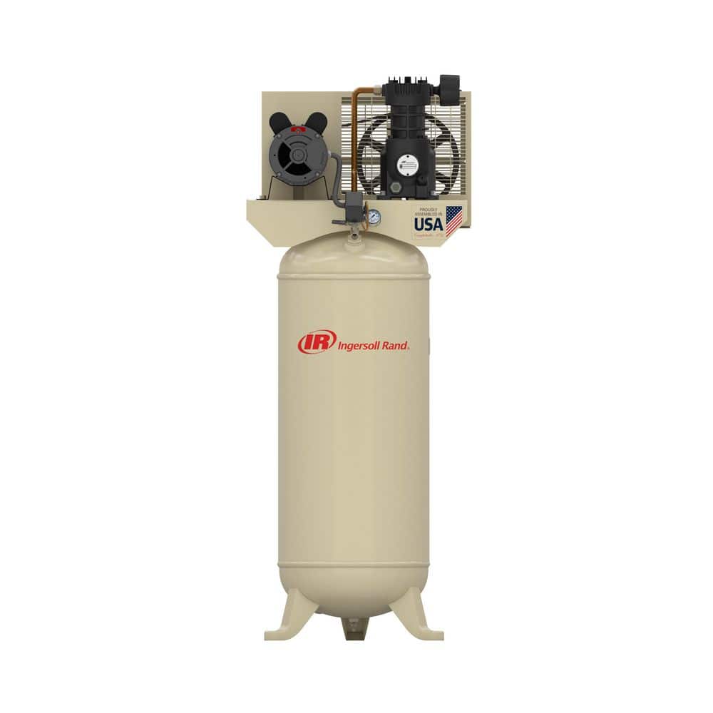

This air compressor is enough for a lifetime of work in your garage if you can add a 230V single-phase plug out there. It is just about the minimum capacity to run air sanders and air-powered body tools, If not a 110 volt less expensive one will still work for a lot of things. You should be able to find a used one for no more than 2/3's of the new price.
$500-600 would be my target.
