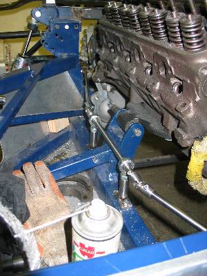

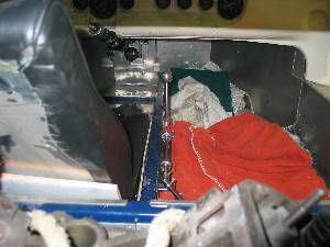

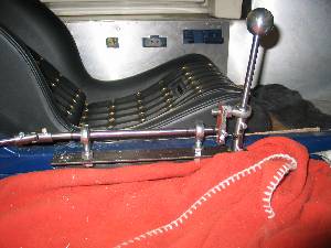

Re: frank's kva
Found the final setup for the gear linkage
it goes like a knife through butter
