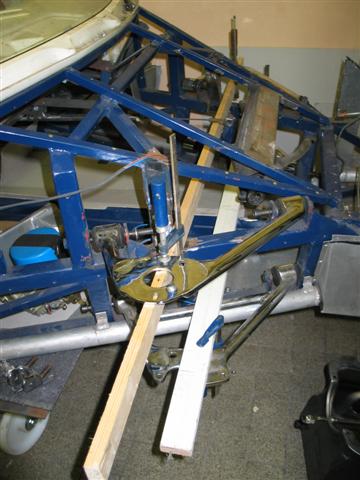

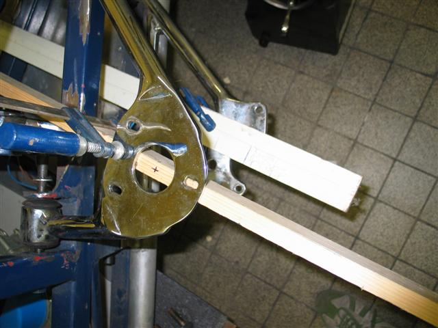

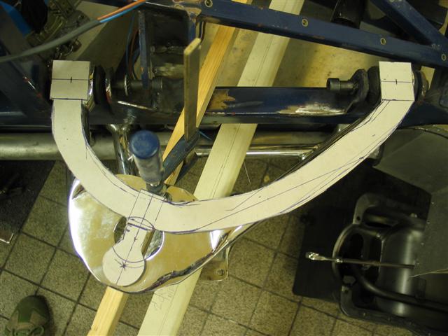

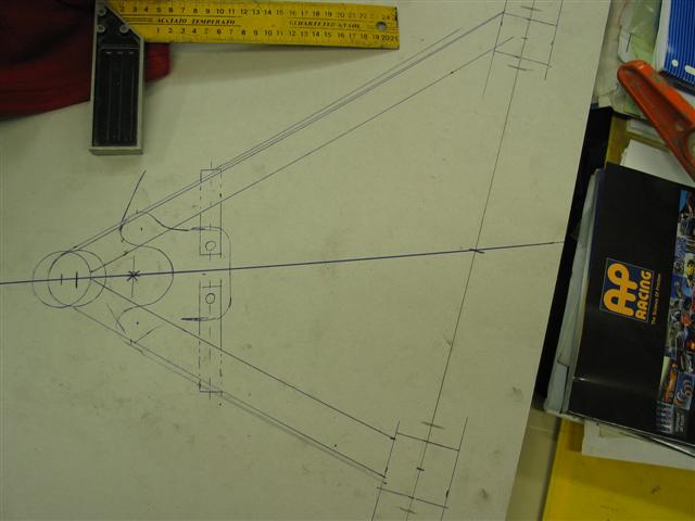

working on the front suspension creating templates for new upper and lower arms
