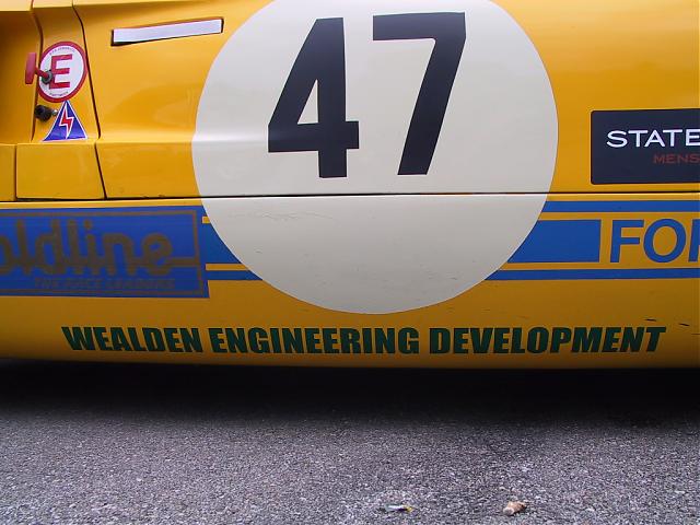

Maybe Frank Catt and/or Ron and/or others could expand on the specifics on what club rules state regarding the placement of the battery cut-off switch.
If someone is building his car, and gets to the placement of the battery cut-off switch, it would be a bummer to find out when you want to track your car.....that the placement of the switch is not acceptable to the racing organization.
I am definately not sure of the specifics, but I would like to learn about it.
Thanks in advance foryour assistance.
The MSA ( UK MotorSportsAssociation - the governing body ) scrutineers always advise us that they like to see the external electrical kill switch as close to the drivers door opening as possible as this the first place a safety marshal will go to, but as Malcolm says this is only practicable if the car is not stuffed into the safety tyre wall on the drivers side. Likewise, the marshalls do not like high mounted switches which could be inaccessable if the car is inverted, they will not crawl under a car to attempt to find the switch. It seems to be doubly sure that the best solution is an electrically triggered or a pull toggle on both sides of the car would be the best solution, but most are happy just have sufficient to get scrutineering approval on the day. Frank
Malcolm
Competitor Safety (Q) page 166 MSA Blue Book 2007 Para 8 reads.....
"External circuit breaker.
The circuit breaker when operated must isolate all electrical circuits with the exception of those that operate fire extinguishers. The triggering system for the circuit breaker on saloons should be situated at the lower part of the windscreen mounting preferrably on the drivers side or below the rear window. On open cars.... (I am not typing that bit in as irrelevant to our cars).
Alternatively on cars of Periods A-F (Note; dates range from 1905-1965 and if you are competing a replica 40, it isn't a period car but you may want it to look period for other purposes) the mounting point may be mounted approximately vertically below the line of scuttle on the drivers side.
The location must be identified by a red spark on a white edged blue triangle (12cm base) and the on and off positions marked clearly."
IMO this is unlikley to be changed for 2008.
Malcolm
Car Racing (J) page 274 of MSA blue book 2007 para 20.11.1 reads.....
"Circuit Breakers and ignition components
Be equipped with an externally operated circuit breaker having positive ON-OFF positions clearly marked (Q8 (see above)). An external circuit breaker is not mandatory on open cars of periods A-F but is strongly recommended. An internal ignition switch must be operable by the driver when normally seated irrespective of whether a safety harness is worn or not."
Out of interest 20.11.2 goes on to say no ignition components, coils, cables, or black boxes are to be located in the cockpit area of racing cars.
The blue book rambles on on page 318 for Hill climbing and sprinting para 10.6 as follows.....
"10.6.1 Must be equipped with an ignition cut off switch having positive On-Off positions clearly marked. The ignition cut off system must be operable by the driver when normally seated with seatbelts secured. It must also isolate electric fuel pumps.
10.6.2 is about lighting so I skip that one.
10.6.3 An external circuit breaker to Q8 (see above) is mandatory for all cars except open cars of periods A-F and cars licensed for road use (when it is recommended)."
When it says road use at teh end there, please note that only applies if you compete your car in full road legal condition. If you drive to an event, swap tyres to road illegal tyres you no longer comply with road use conditions.
These are the FIA/MSA competition rules for the UK only and are not mandatory for track days or SVA or for other parts of the world. How individual owners/scrutineers choose to interpret them is down to them. I have always thought that the picture Frank shows is not in compliance with the rules although GTD competition guys run their cars like this and have not suffered at the hands of scrutineers or marshals. It certainly is a better looking solution to the one I actually think is the technically required solution.
