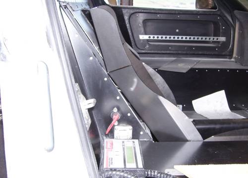

I placed mine just inside the drivers door, close to cable runs etc

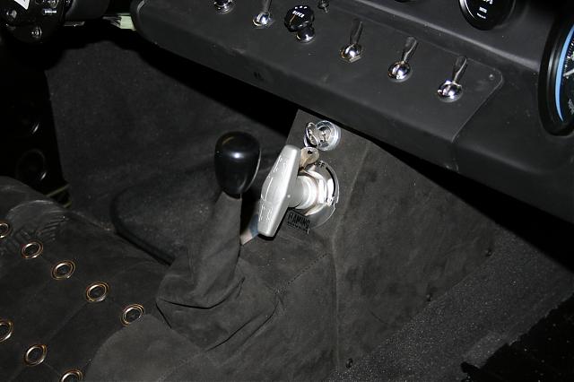

Depends what you want the switch for. If you just want a kill switch for the sake of it/security then choose your spot to suit your whim, but if you want it to function as they are designed and intended (ie emergency use item), make sure you put it where you can reach it in the car when strapped in tightly. Mine is in front of the gear lever on a panel I made at the base of the dash leg.

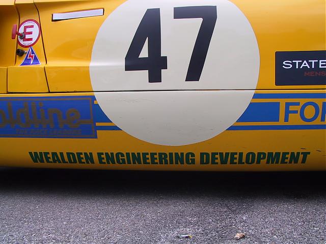

Externally to comply with MSA Blue Book regulations it should be on the front clip at the base of the windscreen in front of the driver. This is a pain to fit but can be done. Many however have it in the cut out just behind the drivers door on the side of the car. Great right up to when you slide into a tyre wall and it cannot be reached by a marshal/corner worker whilst you are trapped in the car. At least if you flip the car and it is still a relevant issue, the base of the windscreen stands more of a chance to be accessible by marshals/corner workers.

The MSA ( UK MotorSportsAssociation - the governing body ) scrutineers always advise us that they like to see the external electrical kill switch as close to the drivers door opening as possible as this the first place a safety marshal will go to, but as Malcolm says this is only practicable if the car is not stuffed into the safety tyre wall on the drivers side. Likewise, the marshalls do not like high mounted switches which could be inaccessable if the car is inverted, they will not crawl under a car to attempt to find the switch. It seems to be doubly sure that the best solution is an electrically triggered or a pull toggle on both sides of the car would be the best solution, but most are happy just have sufficient to get scrutineering approval on the day. Frank
