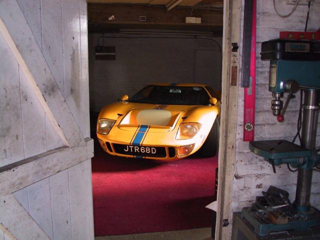

Re: Garage Flooring
Sorry guys, nothing beats car pet! Frank

Old 04-03-04, 05:15 PM   #72 (permalink)
p thompson's Avatar
p thompson
Administrator
Join Date: Aug 2002
Location: Milland, West S
GT40: None
Posts: 2,212
Re: Garage Flooring
Hi Frank -
My 'simple picture posting' instructions worked then! [img]/ubbthreads/images/graemlins/smile.gif[/img]
(whoever said you can't teach an old dog new tricks?) [img]/ubbthreads/images/graemlins/grin.gif[/img]
p thompson is offline

Re: Garage Flooring
Like that red carpet!!!! Do you think it would look good under a blue GT-40?? I bet red and blue goes good together. Joe [img]/ubbthreads/images/graemlins/laugh.gif[/img] [img]/ubbthreads/images/graemlins/laugh.gif[/img] [img]/ubbthreads/images/graemlins/laugh.gif[/img]

Re: Garage Flooring
That does look good! And I bet it's a dream if you have to get down on the floor to do something. Is it easy to clean?

Re: Garage Flooring
I have navy blue carpet and it looks great with the red car on it. Just make sure that the car is house broken first. [img]/ubbthreads/images/graemlins/grin.gif[/img]
