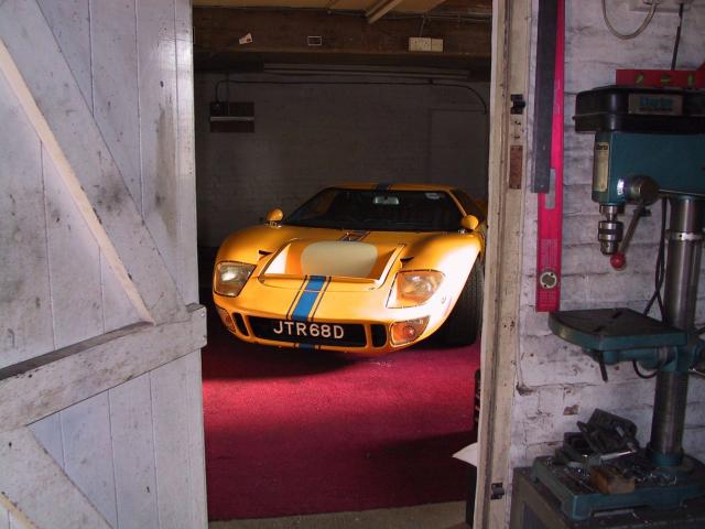

Sorry guys, nothing beats car pet! Frank
Hi Frank -
My 'simple picture posting' instructions worked then! /ubbthreads/images/graemlins/smile.gif
(whoever said you can't teach an old dog new tricks?) /ubbthreads/images/graemlins/grin.gif
Like that red carpet!!!! Do you think it would look good under a blue GT-40?? I bet red and blue goes good together. Joe /ubbthreads/images/graemlins/laugh.gif /ubbthreads/images/graemlins/laugh.gif /ubbthreads/images/graemlins/laugh.gif
That does look good! And I bet it's a dream if you have to get down on the floor to do something. Is it easy to clean?
Rick Merz
I have navy blue carpet and it looks great with the red car on it. Just make sure that the car is house broken first. /ubbthreads/images/graemlins/grin.gif
Will do Rick. I spanked mine yesterday and it is clean as a whistle. Joe /ubbthreads/images/graemlins/laugh.gif
