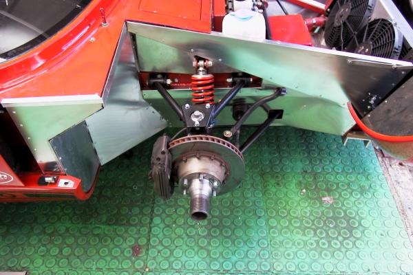

Roy's floor in his workshop is now coated with a two-pack epoxy coating - works well athough will 'chip' if you drop a heavy metal (with corner) item onto it. Also somewhat slippery is you let oils or water leak onto it.
Roy's previous floor system was a tile system that to me looked identical to the one James details and to use his words, Roy would describe it as 'bloody useless' for a garage. With the best will in the world, fluids get spilt and with this system they run between the joints and get below the tiles. If petrol or other strong solvents are spilt, the tiles then tend to bow upwards at the joins. In addition, the small circular indentations and bumps make sweeping or keeping clean a nightmare! they don't sweep well.
All the above failings are IMHO and of course if your car is never dirty, is never driven, has no leaks and you are perfect to the point that you never spill anything - then the failings need not matter....
Roys old floor -

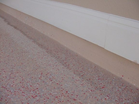

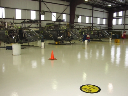

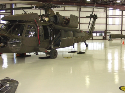

It is possible to get a nice floor. I get a bit obsessive about painted floors, so please excuse me for posting some pictures.

Here's another.

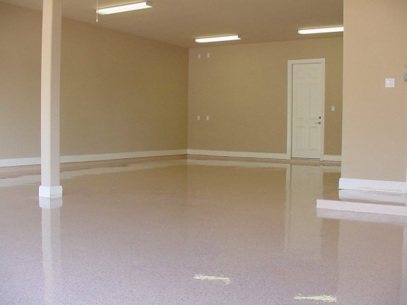

And for a decorative look...
When can I move into your garage? I'll bring food and beer? That is beautiful. Do you know what the cost per square foot is for materials?

Cost varies with what you want. The hanger with the Black Hawk costs about $0.70 per foot in material plus sundries. The one with the chips runs about $0.90, if quick math in my head is correct.

Malcolm, I am living in a renter right now, while I wait for my new house to be finished.
Floor looks a lot like Pat's pics and is navy warship grey with black flecks. Looks fantastic and shows no dirt.
