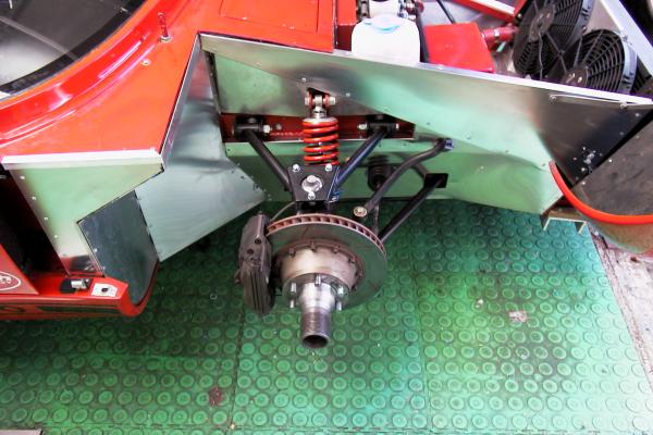

Roy's floor in his workshop is now coated with a two-pack epoxy coating - works well athough will 'chip' if you drop a heavy metal (with corner) item onto it. Also somewhat slippery is you let oils or water leak onto it.
Roy's previous floor system was a tile system that to me looked identical to the one James details and to use his words, Roy would describe it as 'bloody useless' for a garage. With the best will in the world, fluids get spilt and with this system they run between the joints and get below the tiles. If petrol or other strong solvents are spilt, the tiles then tend to bow upwards at the joins. In addition, the small circular indentations and bumps make sweeping or keeping clean a nightmare! they don't sweep well.
All the above failings are IMHO and of course if your car is never dirty, is never driven, has no leaks and you are perfect to the point that you never spill anything - then the failings need not matter....
Roys old floor -

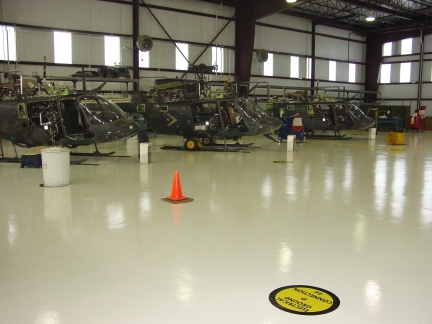

Hey J.P., sorry to hear about your problems. Not the first time though. As with most tings, prep is very important, as is not have high moisture vapor permeation through the slab. One thing a well-coated floor enables you to do is clean it, unlike tile and carpet. But in the end it all comes down to what you like and what you are willing to tolerate as any floor will have its drawbacks.
It is possible to get a nice floor. I get a bit obsessive about painted floors, so please excuse me for posting some pictures.
patbarry is offline

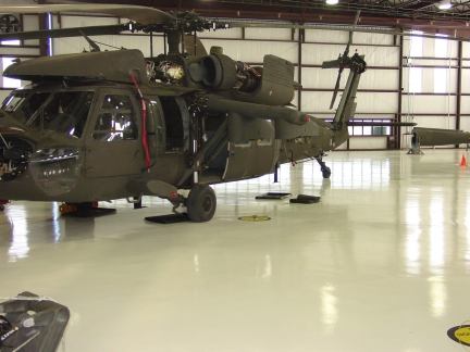

Here's another.

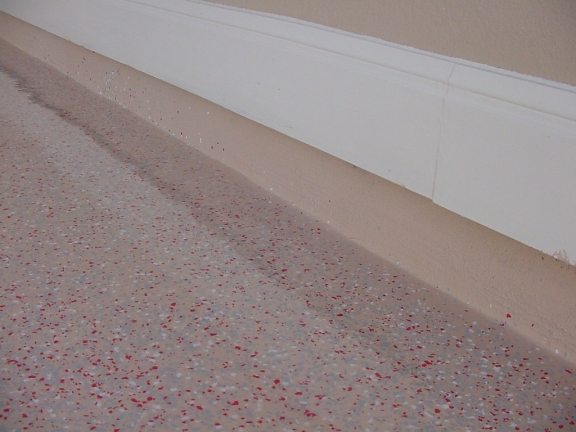

And for a decorative look...
Name:	30839-Mark\'s Floor 2 4x6.jpg
patbarry is offline

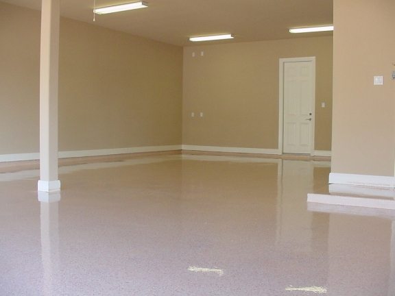

Almost done...
Name:	30840-Mark\'s Floor 5 4x6.JPG
patbarry is offline
Old 02-09-04, 09:34 PM   #34 (permalink)
patbarry's Avatar
Gold Supporter
Join Date: Apr 2002
GT40: Houston, Texas
Posts: 678
Re: Garage Flooring
Done
Name:	30841-Mark\'s Floor 6 4x6.JPG
patbarry is offline
