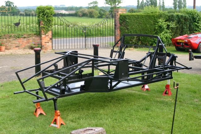

Hi all
As Brett rightly states - Roy Smart continues to manufacture the GTD chassis (licenced), so it IS still possible to build a GTD although an 'off the shelf' kit is not available.
He is not overjoyed at the prospect of using pc's so I will post on his behalf.
An example of the Chassis he produces

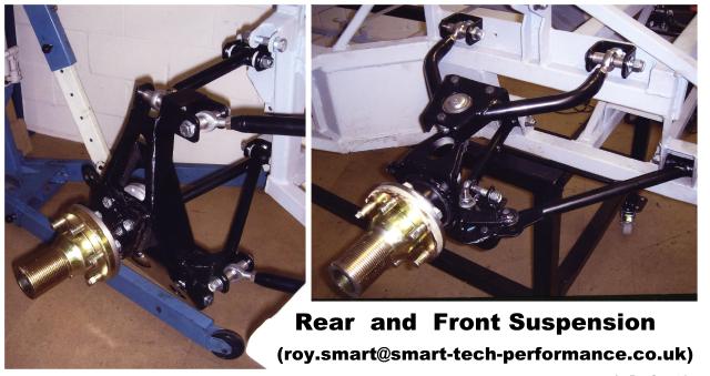

He produces all suspension and uprights too - mods available to order too...
