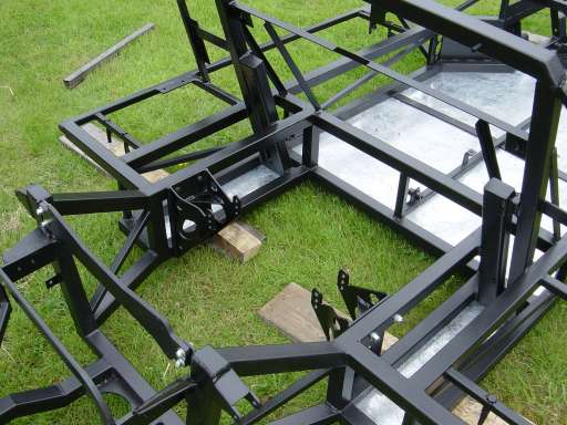

Ian, you mean like my chassis from Roy.
Thanks Brett. Looks like I can add Roy to the list of manufacturers
that added a crossmember between the rear suspension mounts.
Now all I need is a CAV and an ERA. I also saw that Alain V's
Premier GT40 also has such a crossmember. Kalun's scratch built
chassis doesn't appear to have a crossmember in the exact
place, but his tail end of the chassis seems closer to the
suspension pickups, so that might suffice. Again, some
results from him would be cool too, although he is not
mass marketing it.
