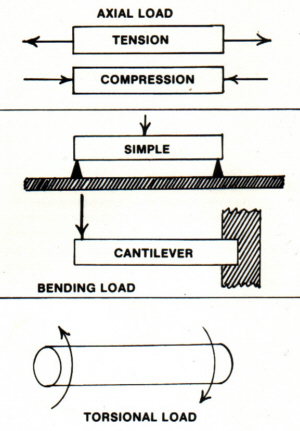

Tube frames are made from steel tubing. A single piece of steel tubing is much stronger when loads are applied on the radial axis (lengthwise) in either compression (pushing together) or tension (pulling apart), as opposed to bending.
Demonstrate this to yourself with a wooden broom handle. Supported at both ends it can be easily broken by pushing down in the middle (simple bending). Or with one end clamped in a vise and push down on the other end (cantilever bending) again easily broken. Now try to break it by pulling or pushing on either end (tension compression), it's much more difficult to break.
Diagram of different loads.

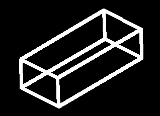

Now that we have established the two common 2 dimensional shapes used (triangle and square) lets expand to the 3 dimensions of a tube frame chassis. The simplest basic shape (almost) of an auto chassis is a rectangular cube. 2 rectangles at each end with the suspension, connected by 4 tubes running lengthwise at the corners.
Flexible cube

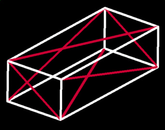

Now this shape is not rigid because it's made up of the basic non rigid shape, the square/rectangle.What if we were to add diagonals to all the rectangles in the assembly? This would make the cube rigid, specifically in all dimensions. With the dynamic loads present on an auto chassis it needs to be rigid in all dimensions/planes especially for the important torsional rigidity.
Rigid cube

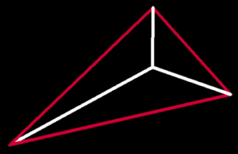

Most importantly ALL sides of the cube need the strength of the triangle for torsional rigidity. This can be easily demonstrated. Locate a cardboard box, preferably one with an opening lid. Now, with the lid closed, grab 2 opposite ends of the box and apply a torsional (twisting) load. Note the amount of load it takes to twist the box. Now open the lid and apply the same torsional load. It twists much more easily.
What you have to realize in the cardboard box test is that each flat rectangular face of the box represents a rectangle with a diagonal. Take away only one diagonal and you loose a larger, more disproportionate amount of torsional rigidity than you would think given the box has 6 sides. This also demonstrates the fact that flat sheet on a rectangle tube assembly can substitute for a diagonal tube, in essence adding diagonal strength. All the more reason to affix sheet metal panels in a stronger structural fashion so they can contribute strength and not just weight.
You can also break down the diagonally braced cube into it's more basic rigid component. That 3 dimensional shape is the tetrahedron, or three sided pyramid. This is a shape you will see in chassis when a cube is not practical or applicable.
tetrahedron
