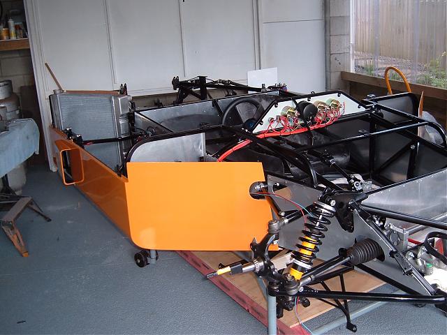

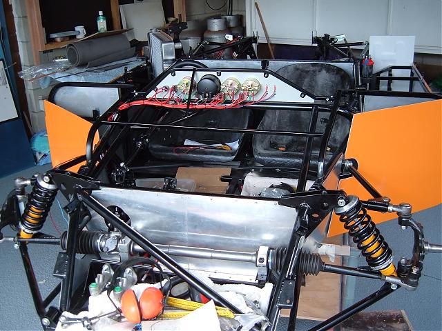

Thought I would drop in some pictures of my project which was started 3 years ago. Basicly its a fairly close visual copy of the Denny Hulme #5 1970 Can AM car built on a tube chassis of my own design. It`s running a Rover V8 via an Audi Transaxle and 4 Twin choke downdrafts for the right sound. All the body work is complet, painted and the car is being asembled for the final time so its good fun to bolt in the shiny bits. I have yet to build the motor and that will be the final task. A good friend of mine has done all the graphics to the origional so the car should look the part and make the right noise.

Re: McLaren M8 B look alike

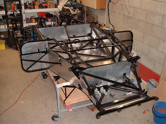

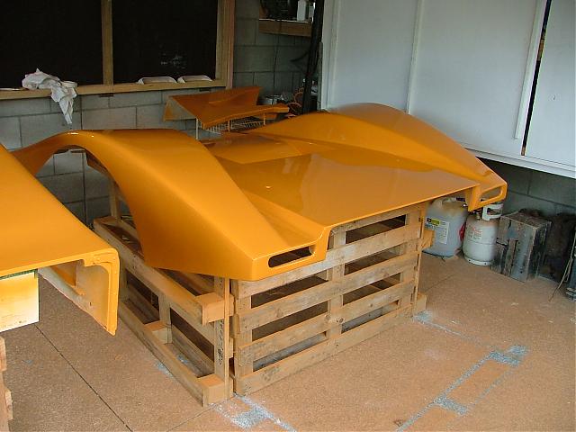

Another try
Name:	Chassis assembly 3.8.2007 001.jpg
ID:	23842  Click image for larger version
Name:	Chassis skined 001.jpg
ID:	23843  Click image for larger version
Name:	the paint job 005.jpg

more progress
Name:	Mclaren 25.9 002.jpg
ID:	24020  Click image for larger version
Name:	Mclaren 25.9 004.jpg

Sorry to disapoint you but I have gone conservitive with a Rover / Buick 3500 V8, Cam and 4 twin choke down drafts just so that it will make the right noise. I should have about 240 / 250 hp in 650kg (1300lb) of car thru an Audi 013 transaxle, That means it has the same power to weight as my brothers Viper. 500hp to 2700lb and thats enough.

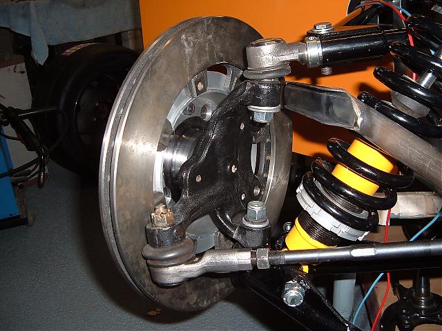

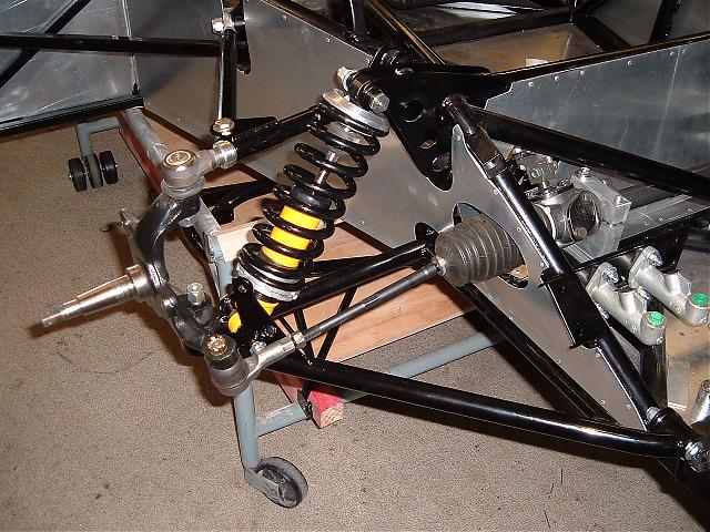

What front uprights and upper ball joint (Ford Transit TRE?) are you using?

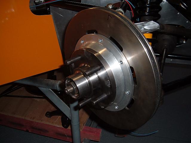

Sorry can not remember but the 555 brand box has these part numbers se-1441 or 8ABI32-280 or BF3P 84 OUT. As you can see in the photo, I have had turned up new hubs to take the WILWWOD dics and change the off set to improve the scrub radius. The calipers will bolt on via an adaptor plate in the standard mount position.
The stub axel / upright is MK 4 Cortina and the bottom ball is I thing Triumph.
Name:	Front hubs 003.jpg
ID:	24090  Click image for larger version
Name:	Front hubs 002.jpg
