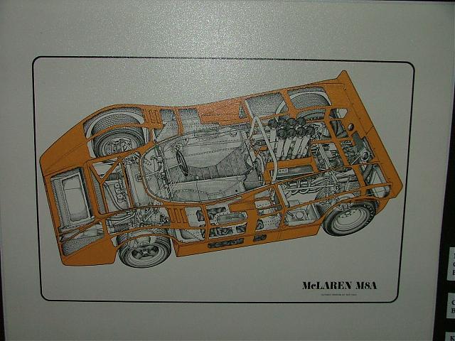

Yes most of the origional car body work was fibre glass, with the exceptions of the side `tanks` which were alloy skins over the chassis / monocoque structure and housed the fuel cells. I do have a cut away drawing that will show all that for you.

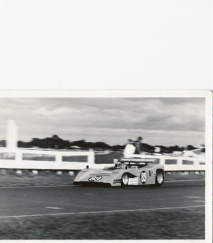

The first picture shows the copy called the GEMCO SPECIAL built in New Zealand in 1971 that I have used as a start for my body work. This was taken by me and little did I realize what the future held. The second is the cut away drawing of the Mclaren.

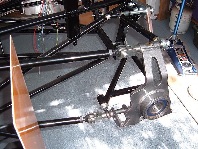

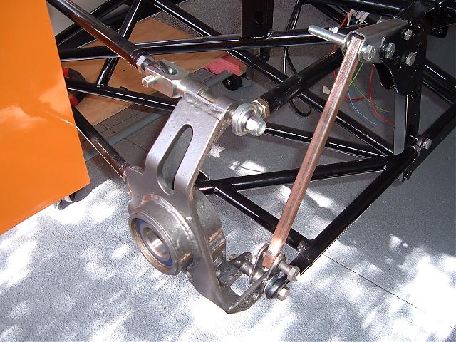

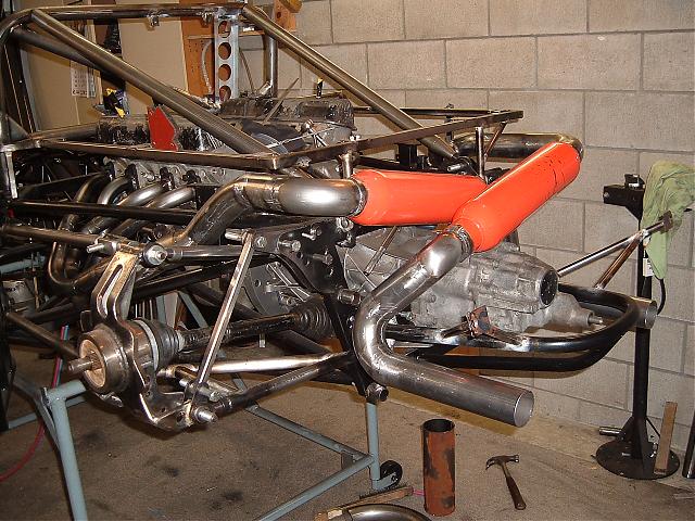

The gear box is an Audi 013 which is the same dimensions as an 016 but with a different gear shift location typicly out of an Audi 100 or similar.
I have set up the rear suspension as per typical for the era of the car and if you wished it could easily be set up with a twin wishbone system so that you did not have the toe in variation in the travel. I have used the entire Audi drive shaft and hub and front bearing set up but would change back to a local aluminium casting that runs Holden bearings and CV`s etc. which look identical to Audi any way. They are specialy made for the NZ produced Cobra`s that are running as much as 500 plus HP thru them.
The up rights that I made were a bit of an effort but will also run the Audi front vented disc`s and calipers as I do not need a hand brake. As you can see i have added a toe in adjuster in case of any mis alignment.

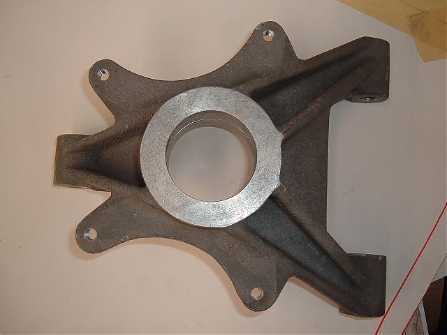

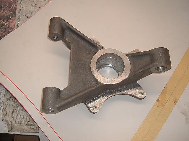

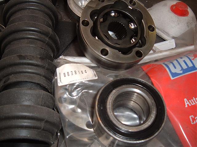

The pictures show the uprights that I found after making mine, as you can see they take a very wide rear Commodor bearing and the same cv joints as AUDI. These are very well built strong units with a wide attachment spacing.

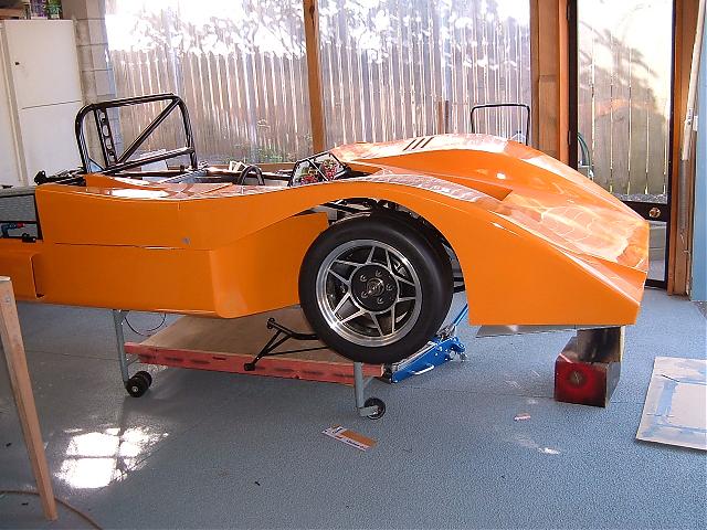

A bit more progress with the front clip being fitted and the door sitting in place. I have just fitted the calipers, radiator.oil cooler and other shiny bits so feel like we will be on our wheels by Christmas.

Hubba Hubba - that looks awsome Russ
