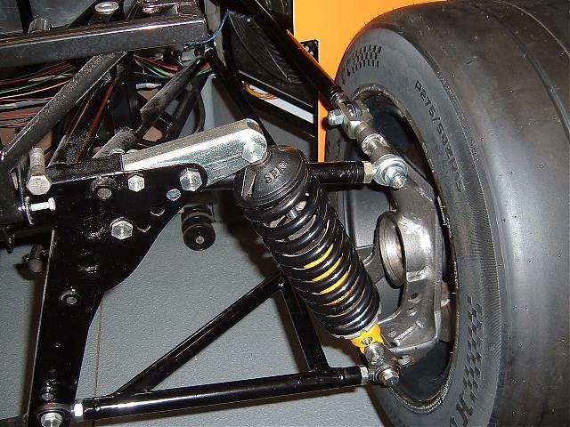

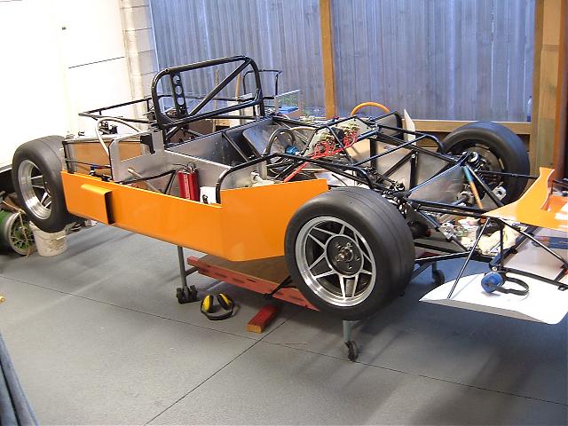

Well I promised to myself that I would have 4 wheels on it by Christmas, so 4 years to get 4 wheels on is? I had finally got all my hub parts in the one place and pressed them to gether, and they still turned round. Lots of measurements to co ordinate so its nice when it all works.The motor is now being stripped down ready for a freshen up plus a cam and some other bits. I have made the manifolds to take the 4 x twin choke carbs so we might see a bit more action early next year. I plan on spending some of my holidays on man time.
Hope every one has a relaxed break.

This is going to be an awesome machine! Good job, Russell.

Is it just the camera angle or have you turned the heads down on some of the bolts? For lightening? That's getting pretty serious....

Yes just for fun where bolts are only in the shear situation I whacked the heads back a bit to make them look sexy!! and lighter. Found an even easier way to take some weight out of the car was to slow down my food intake so now can add some 16 kg of go fast bits....

Try jogging round the block as well
You could also shorten up the nylocs. But spending that time jogging may be more beneficial WRT all up weight.

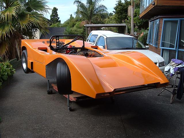

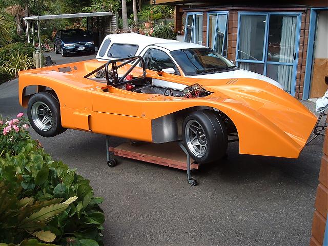

Just a little more progress, I have fitted all body panels ready for the decals. We are putting the car in a local car club show, so its got a dummy motor, half assembled so that people can get an idea of how it will look. Basicly its ready for the final fit out and set up.
Does any one have some ideas on basic settings for the wheel alignment. The set up is not too dissimilar to a GT40. I have every thing ready to assemble once the short block is back from the reconditioners.

Russell, I have mate who is Mclaren nuts, first thing he asks when he calls in here is how is that guy up north getting on with his- these latest pics are gonna cause some trouble around here!!

I caused some trouble just befor I took those picture. I had just added the shocks to the rear for the display and was standing at the front when it slowly ttipped ove backwards. All I could do was slowly allow it to land on its rear wheels with no damage or impact. Then is was a mission to get it back up on the trolley. Its going to have to get down onto its wheels soon now as its getting heavy.
From your vast knowlege bank, any thoughts on alignment. Basicly I was just going to ask some of the F5000 guys and start some where there. A couple of the Mclaren 5000`s were running neutral front and up to 2mm toe in on the rear.

Front-I would start with around 1mm toe in with 2.5° neg camber at ( Hoosier recommend up to 3° negative )- bed in is critical, get on the website for info & dont leave em out in the Sun anymore than necessary!, might need a little more toe in depending on your front scrub radius ( imaginary line thru top/bottom ball joints to tyre contact patch.) Looks like you might have about the right amount of castor on RF by pic ( RH lock & slight positive camber gain ).
Rear- You have to start somewhere & tyre temps/wear pattern will be best indicators.
2° pos Castor, 2° neg camber,2mm toe in would be simple to remember as a start point and shouldnt create any weird handling traits while you deal with all the little stuff that usually appears on your first drive.
