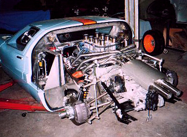

Hi Steve,
We've put a lot of effort into making the ZF application work as smoothly as possible. I can send a list of parts and methodology to you. Please email me back on your own email.
Although CAV has been turning out GT40s for quite a while, the first car for any Distributor or Dealer is the biggest challenge. I have to thank Frknfast for being so patient.
That said, the build quality and materials in the CAV GT are absolutely top shelf. We had to be sure the drive train met those standards.
The real excitement will come from the driving experience (after you recover from the visual impact and sound!). I'm sure Frknfast will keep you posted

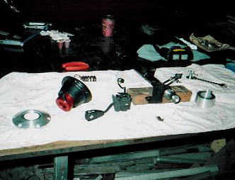

Hi Vic,
The Quick Release Hub & Steering Colume Shaft End are all race car parts you should be able to buy from any local racer supply. We have chosen an anodized, push button type with a hex drive.
I wouldn't recommend a spline drive for the street. With a six sided post to slide the wheel onto you'll always end up with the steering wheel strait. Since this picture was taken the end of the hub has been painted black and an "UP" indicator arrow added.
The aluminium collar with turn signal trip post must be discarded plus there is welding and machining required to make it all work. It's handy to have a lathe and mill in your shop, saved us a lot of gurking around.
We can modify your colume for you if you like. Let me know at: cavgtcanada@yahoo.com
