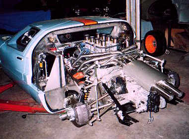

The complete drivetrain is in!! Headers are on (good thing CAV numbered them). Should have its first start up today. Next few days will be fine tuning, adjustments, bleeding of lines etc. I hope to take it out around the block a few times this weekend. Also have made a stainless steel heat shield over intake and in the process of making a heat shield around weber carbs and carb deflector over the top of the carbs. Next week it will be titled and plated. For now using a dealer plate.
Finally complete. First few word I heard in the shop were "Its horny"!!

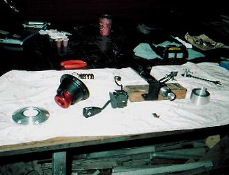

Where did you get the parts for the Quick release steering wheel. What are the part nimbers.

The Quick Release Hub & Steering Colume Shaft End are all race car parts you should be able to buy from any local racer supply. We have chosen an anodized, push button type with a hex drive.
I wouldn't recommend a spline drive for the street. With a six sided post to slide the wheel onto you'll always end up with the steering wheel strait. Since this picture was taken the end of the hub has been painted black and an "UP" indicator arrow added.
The aluminium collar with turn signal trip post must be discarded plus there is welding and machining required to make it all work. It's handy to have a lathe and mill in your shop, saved us a lot of gurking around.
We can modify your colume for you if you like. Let me know at: cavgtcanada@yahoo.com
