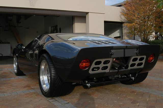

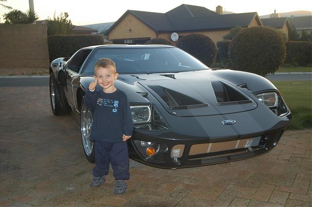

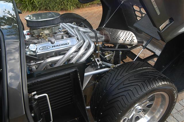

After working mainly on weekends, my car is finally on the road. Firstly: It has been a fantastic experience building this car. The backup & support from Jean and John at Auto Futura has been incredible. Sorry that I did not put it on the builders forum, but I enjoyed it so much and forgot to take photos. Herewith some pics taken on Saturday. Will keep on posting more in the weeks to come. Thanks again Jean!!!!

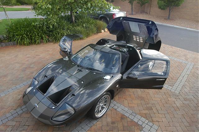

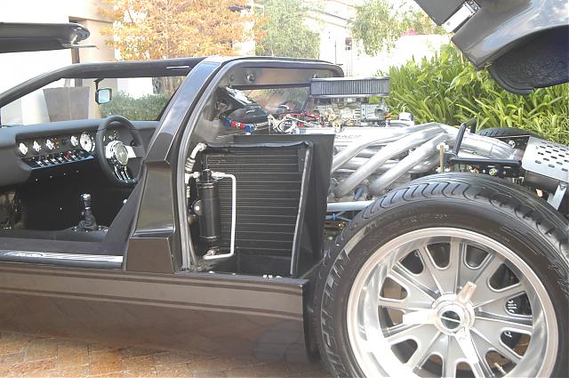

...some more!

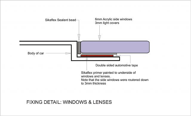

I didn't see any screw heads on the headlamp covers - what did you use to hold them on?
And did you actually put Armor-All on the treaded surface of your tires?

Same screwless look goes for side windows too. I would be very interested to know more about this.

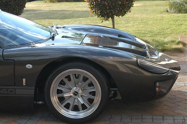

Attached some detail around the screwless windows and lenses. Headlamps can be set from the rear. Just looks smoother than with all the screws.

Great information regarding the windows. Not only good info, but an excuse for another picture no less! Ross is right it looks awesome. Another question if I may - your side windows also look very cool. Are they standard CAV issue or have you snaffled them from somewhere else?

Another photo just for you. The windows were made for me by
the factory that makes the windows for CAV. I selected a 6mm tinted Acrylic that gets used to make aircraft windows. I then made it fit and took it back to the factory to get the edge routered to 3mm thickness. The thicker opening window also looks better than the standard 3mm.
