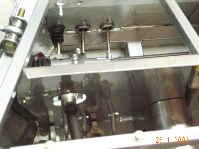

Thanks Mark, The pedals are tilton # TIL 72-6422A. I had to cut the back of the mount off and also had to separate brake & clutch so I could move them closer together. I purchased my car when Robert offered just body & frame along with glass, fuel tanks, & suspension. I wish I could have purchased the complete kit but I wanted to start on the build rather than save longer for the complete kit. It really hurt to cut the rack & master cyl. mount
out but I like the dual cyl. with the balance bar adjuster witch will be mounted behind the shifter.
Simon
http://racecareng.com/RCE/index.php?...no=TIL72-6422A

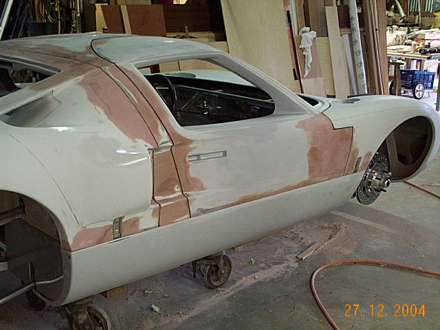

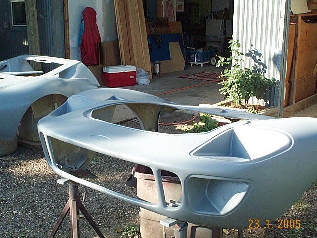

After lots of sanding I finally got two coats of primer on last week, just two more to go. [img]/ubbthreads/images/graemlins/mad.gif[/img]

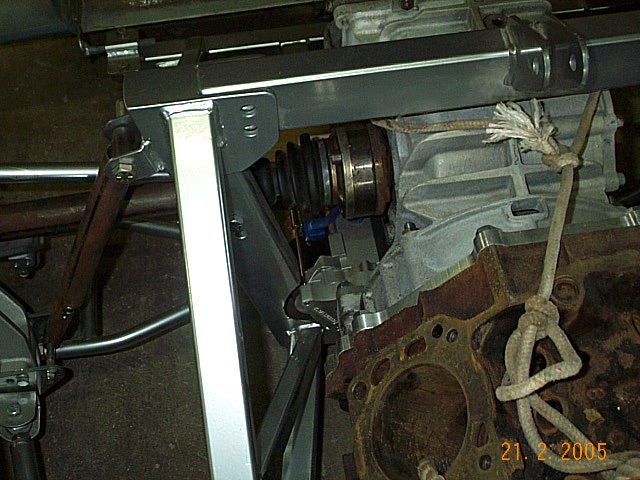

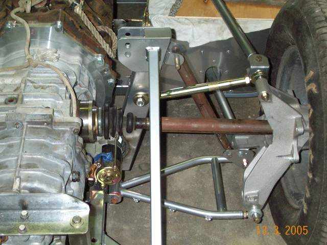

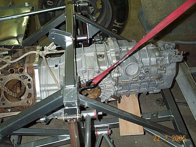

Installing the G50/50 will require some frame modifications for starter clearance.

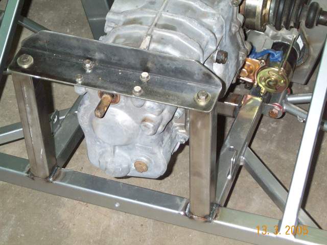

Notch for starter plated and new upper control arms to clear axles.

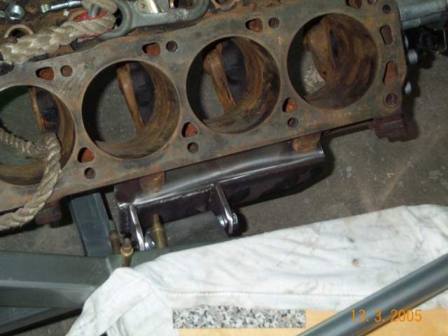

engine mount

trans mount ready for primer

Old 08-09-04, 09:23 PM   #32 (permalink)
SPHameka's Avatar
SPHameka
Join Date: Nov 2003
Location: Texas coast
GT40: RF GT40 #81
Posts: 190
Rep Power: 6 SPHameka is on a distinguished road
Re: Roaring Forties #81

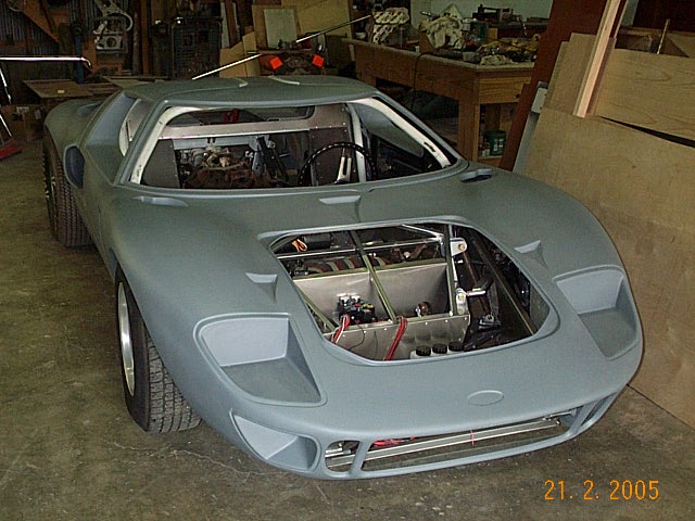

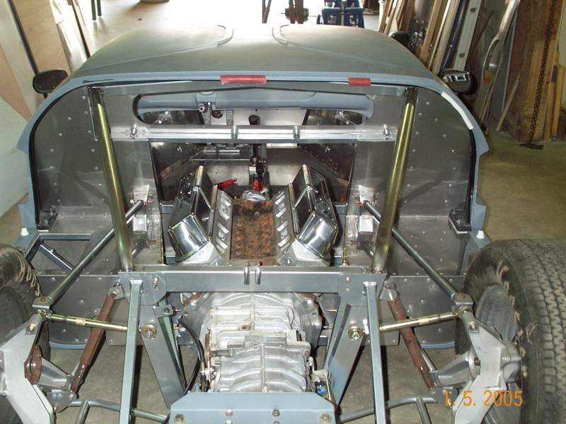

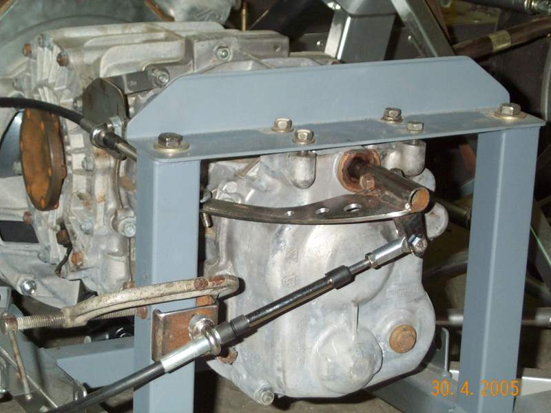

Shifter is almost finished and seems to shift nice, used 43 series morse cables. Engine should be finished this week, 347 roller, AFR 205 heads, Eagle forged crank, h-beam rods,internally balanced. Next project will be the headers, have lots of Burns ss tube and collectors but unfortunately most of it is to big, going with 1-3/4".
Simon
RF #81
SPHameka is offline

next
SPHameka is offline

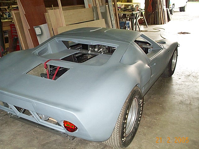

one more for now

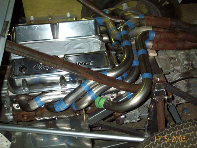

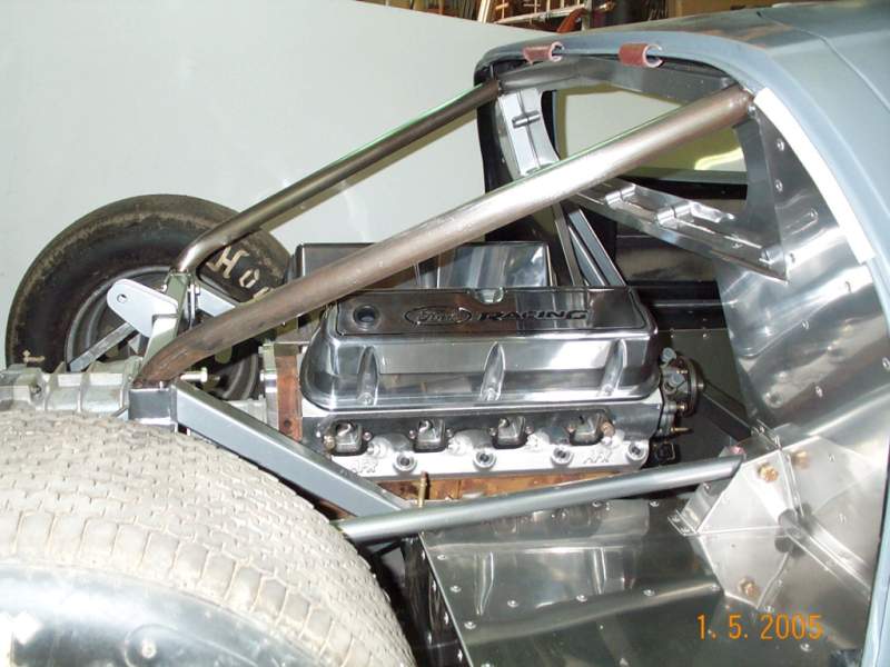

Been doing some cut & paste, some fine tuning left to do and then finish welding this weekend.
Simon
