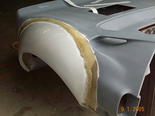

Installed wheel flares this weekend. [img]/ubbthreads/images/graemlins/cool.gif[/img]

Another one

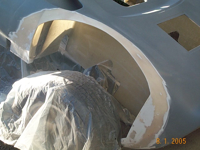

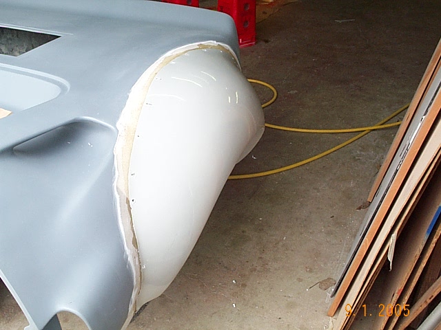

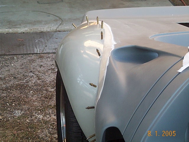

Used pop rivets to hold flares till glass kicked off.

Feathered edges and glassed seam.
Strange, everyone that came by today didn't stay long. [img]/ubbthreads/images/graemlins/blush.gif[/img]

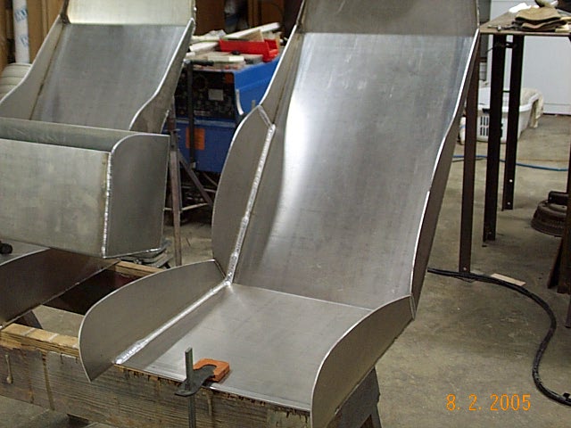

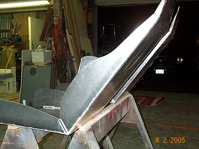

Started on the seats last night. Just a few more pieces and welding.

Finished the seats tonight and they weight 12 lbs. I made them out of the 1/8" marine grade alum. that I had left over from the floor pan.

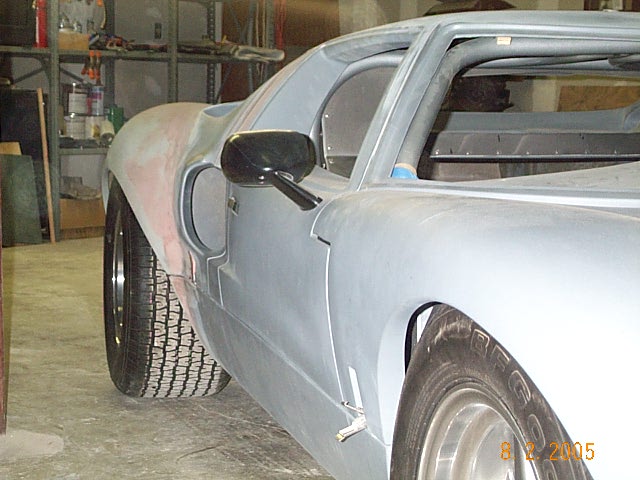

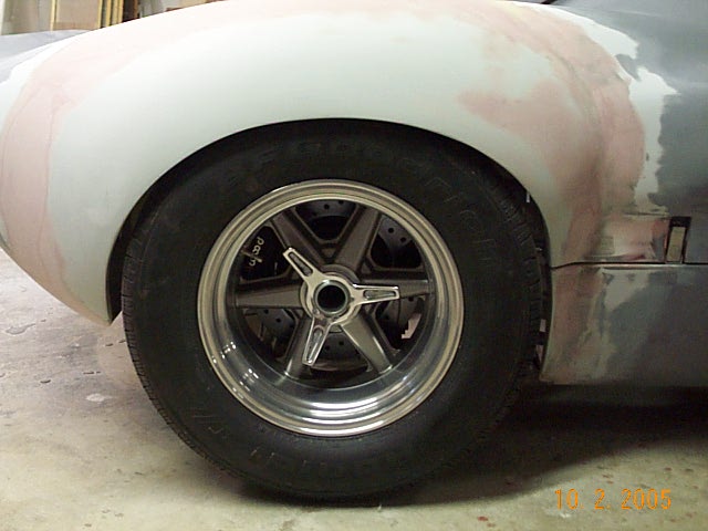

I have 10"x15" vintage wheels with 295/50/15. I think with the right offset or backspace you could probably get 12" to fit.
Simon

clearance

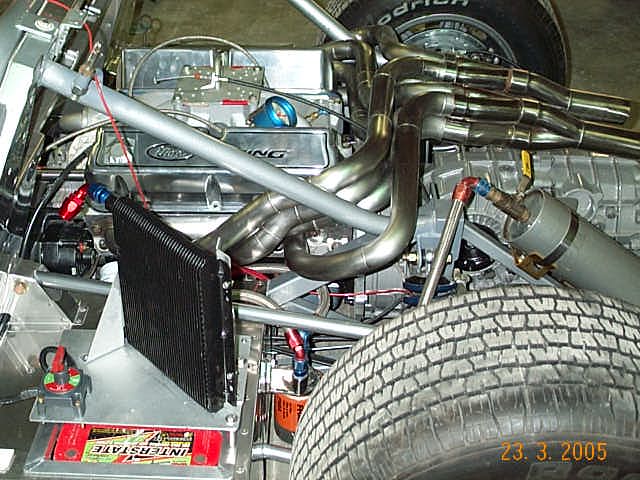

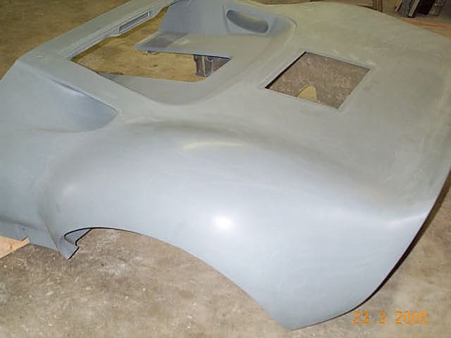

Just one more coat of primer and I'll be ready for paint,I hope. [img]/ubbthreads/images/graemlins/wink.gif[/img]
