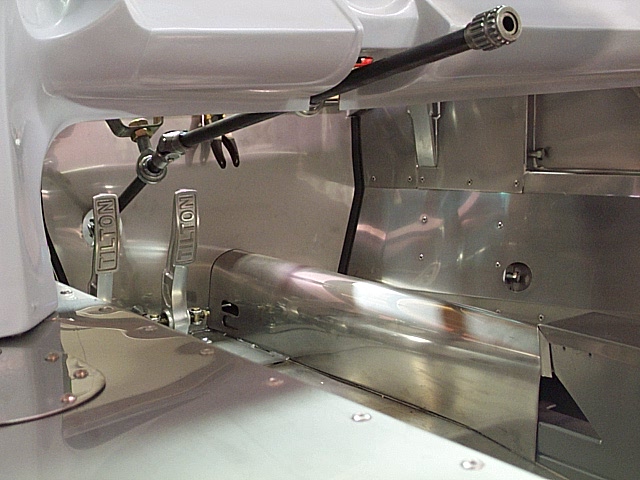

Have been realy busy with work but have most of the paneling done along with steering rack and pedals.

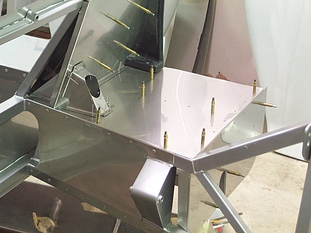

#2

Hi Simon,
The panels look great. Those pedals are beauttiful too!
Keep them photos coming.

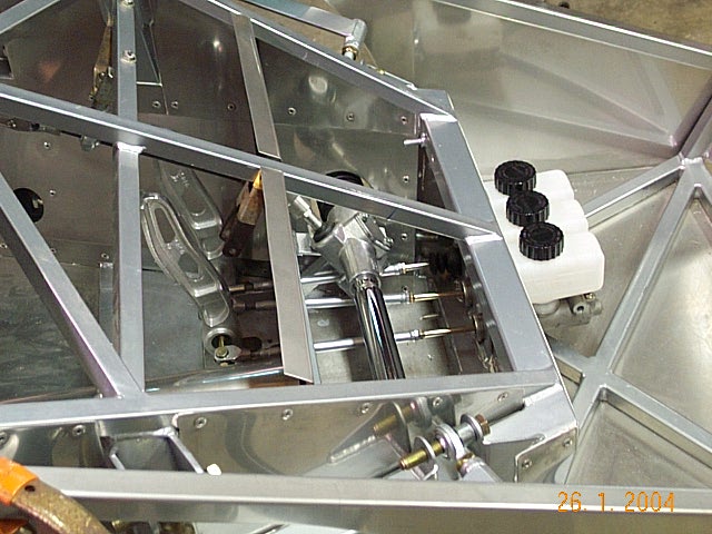

Thanks Hersh,Wish I had more time right now but it's coming along. Next will be brakes & rotors, Wilwood 6 piston up front & 4 piston on rear. I'm also thinking of using a 930 turbo box unless someone can tell me why I should't. How do you like your new trans?

Here's 2 more.

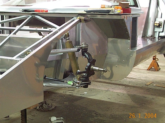

Last one

Looks great! I like that pedal and master cylinder setup. Did RF set up you chassis for that brake system or did you adapt it? Would you mind providing part numbers?
