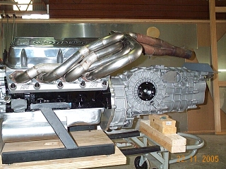

Re: Roaring Forties #81

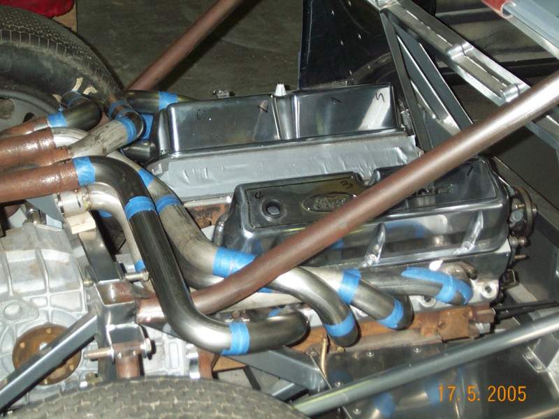

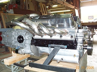

Picked up the engine last week, 347 ,eagle forged crank- internally balanced, eagle H-beam rods. SRP 10.5 to 1, AFR 205 heads, crane gold 1.6 rockers, Isky hyd. roller.

Old 10-23-04, 04:59 PM   #45 (permalink)
aladinsane's Avatar
aladinsane
Join Date: Mar 2004
Location: So Cal, USA
GT40: Tornado
Posts: 759
Simon,
The "bundle" looks fantastic.
If you wouldn't mind fill'in me in, what waterpump do you have installed, anything special? Also while engine and tranny are bolted together can you post the measurement from the back of the motor (where adapter plate mates) to the rear most part of the G50, excluding the shifting shaft?
Again, everything looks beautiful [img]/ubbthreads/images/graemlins/tongue.gif[/img]
Thanks Tim,
The front cover & pump came off my neighbors crate motor, It had the serpentine setup with short pump. I'm not sure what car it came on, maybe someone else can identify it. Now all I need is pulleys.
The transaxle is 27-1/4" from back of eng.& 29" with shift rod extended.
Simon

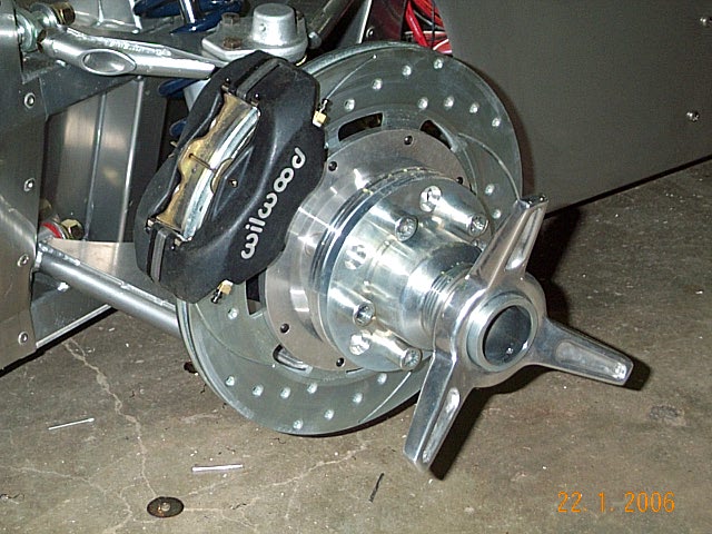

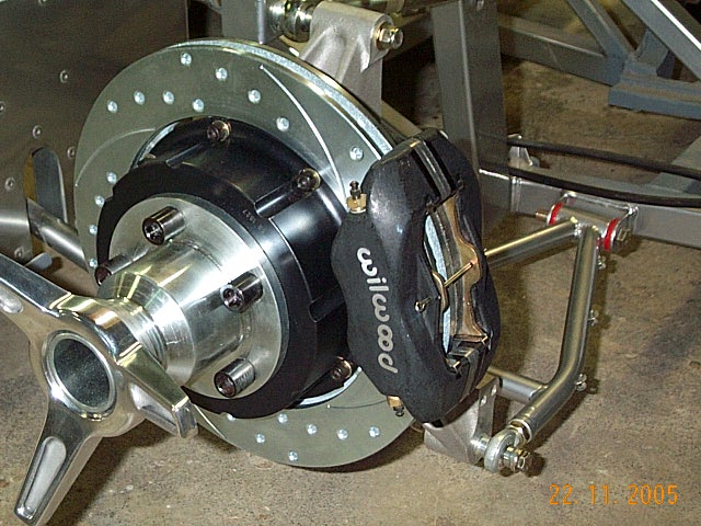

The wheels are from Bob Lacey at Vintage Wheels,
fronts are 8"x15" with 235-60 BFG
rears are 10"x15" with 295--50 BFG
Really happy with the wheels and Bob is a great guy do deal with.
The brakes are Wilwood 12.19 rotors front & rear with 4 piston billet calipers. The rear is a pro kit for big brg. ford rear end 2.38 offset , if you need more info or part # let me know.
Simon

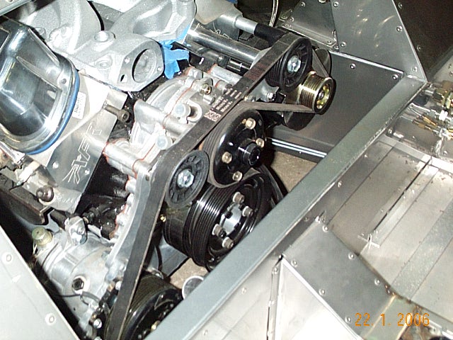

Old 12-23-04, 05:55 PM   #57 (permalink)
SPHameka's Avatar
SPHameka
Join Date: Nov 2003
Location: Texas coast
GT40: RF GT40 #81
Posts: 190
Rep Power: 7 SPHameka is on a distinguished road

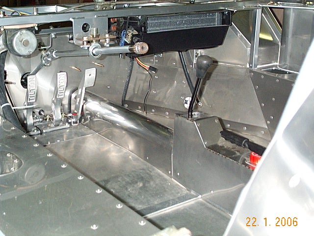

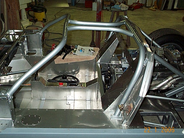

Things are finally coming together. I had installed a Mustang II rack and decided to change it out for a MG rack, my crewcab dually had quicker steering. Pulleys, ac/heat & brakes are finished except for changing out a few bolts. AFCO is building the radiator and hope to have it next week, maybe will hear this thing run in a few weeks.
