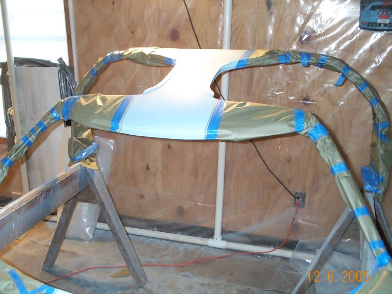

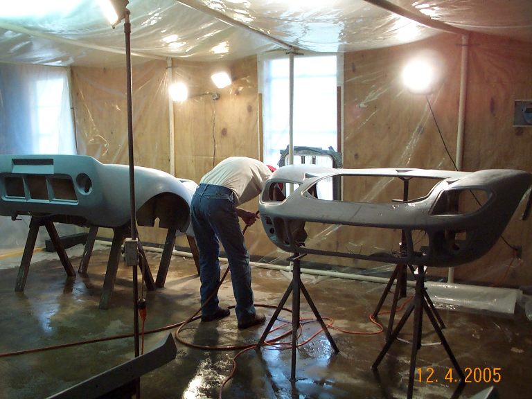

After many months of sanding and priming and more sanding I finally have paint on the car. A good friend Wayne has come down from the other side of Austin TX. to shoot the color & clear, a 5 hr. trip one way.
Here is a pic of the high-tech paint booth.

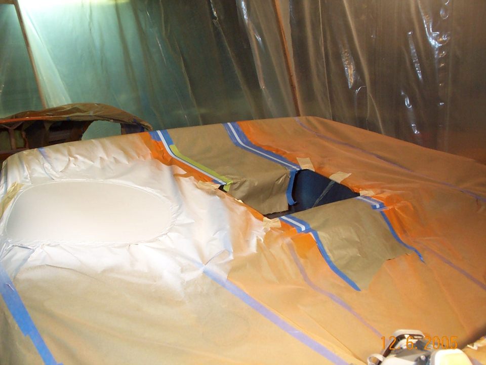

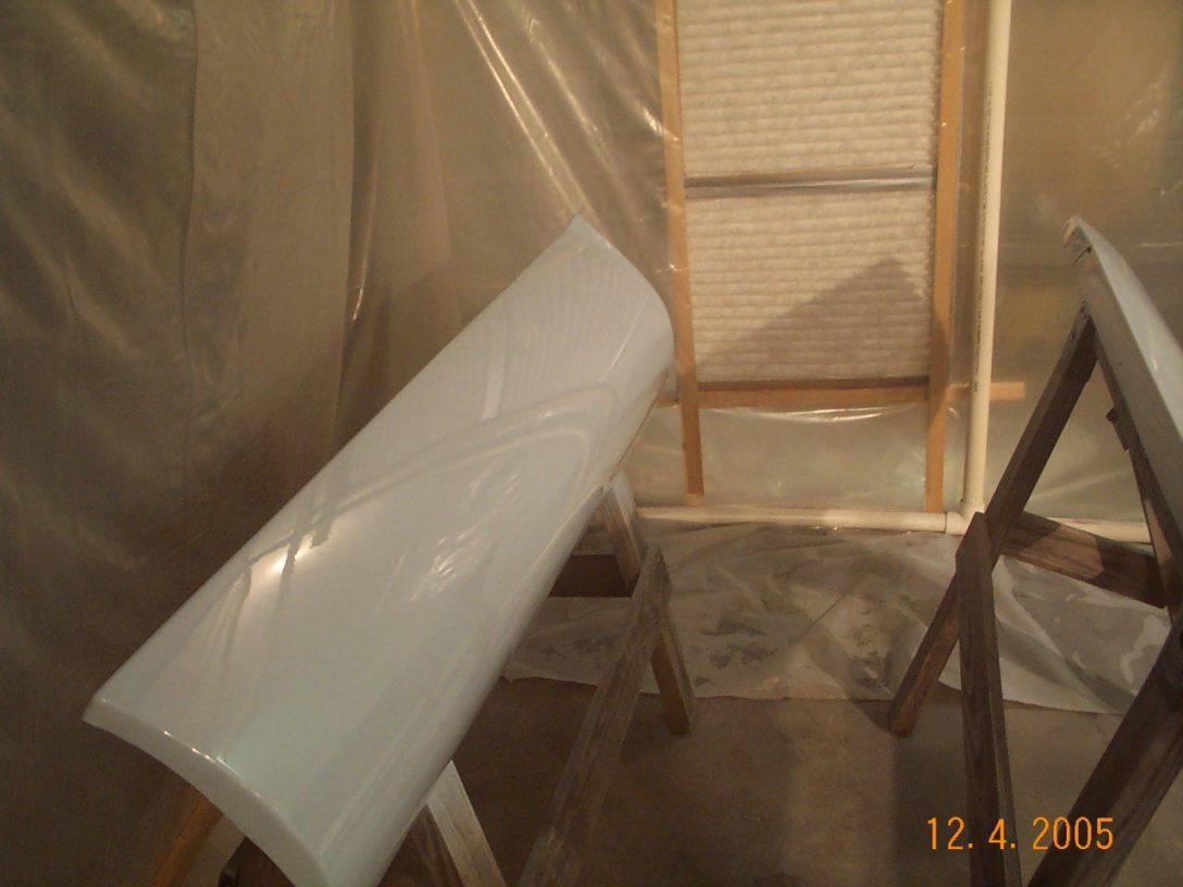

a

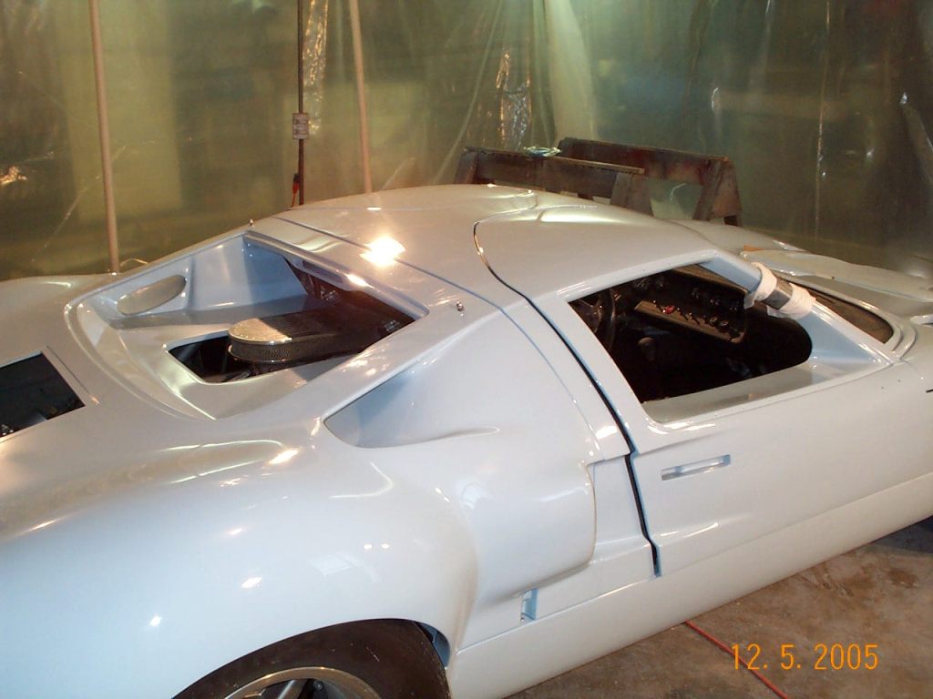

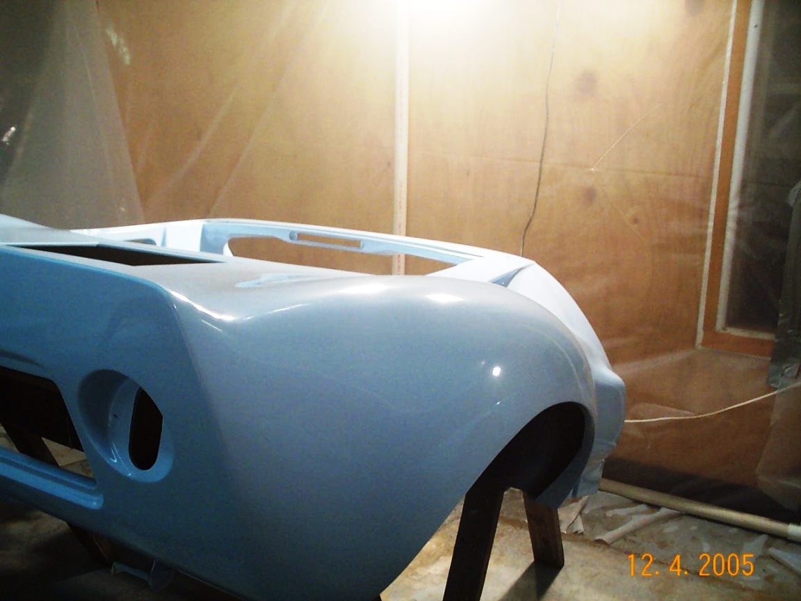

b

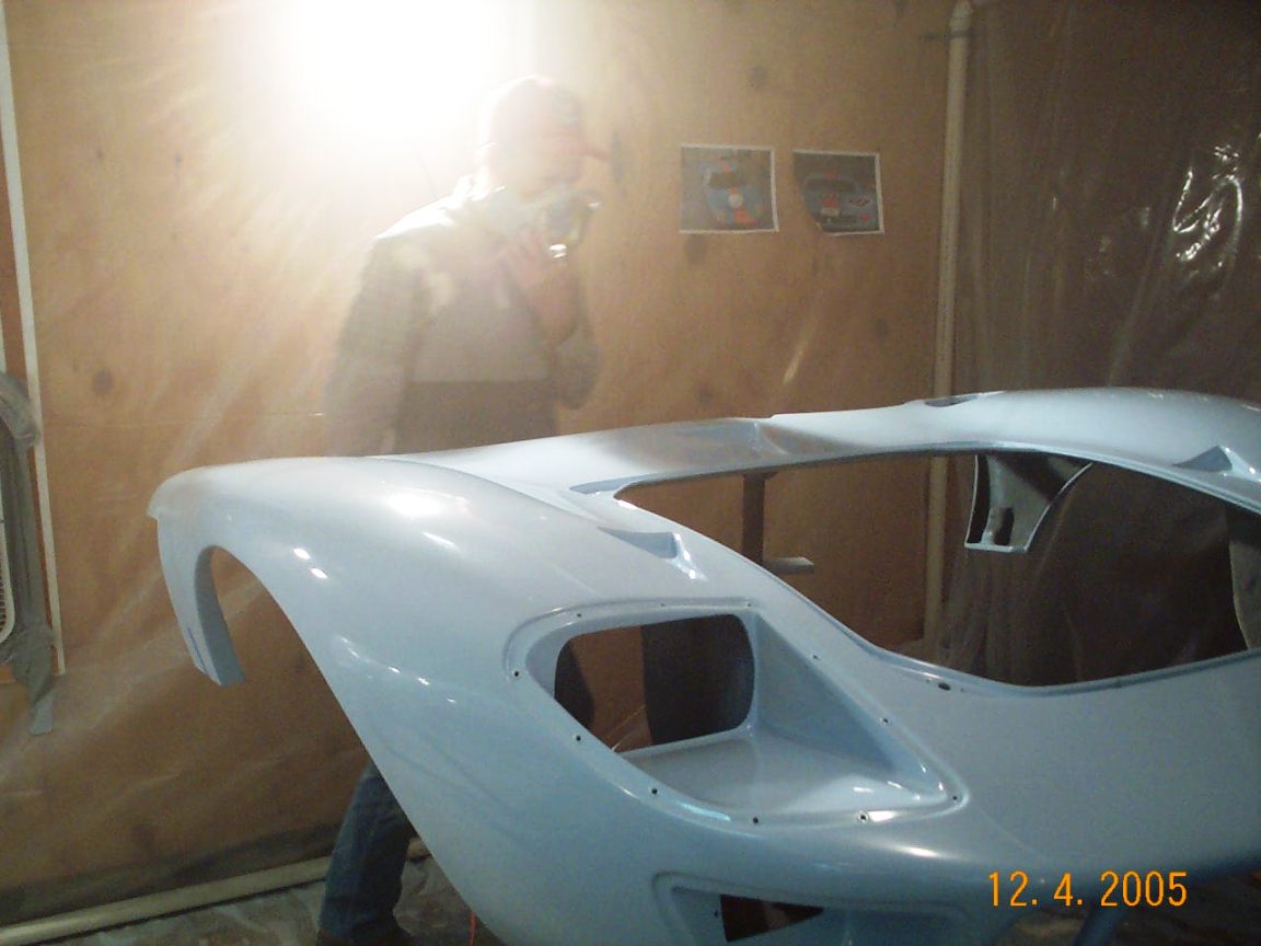

c

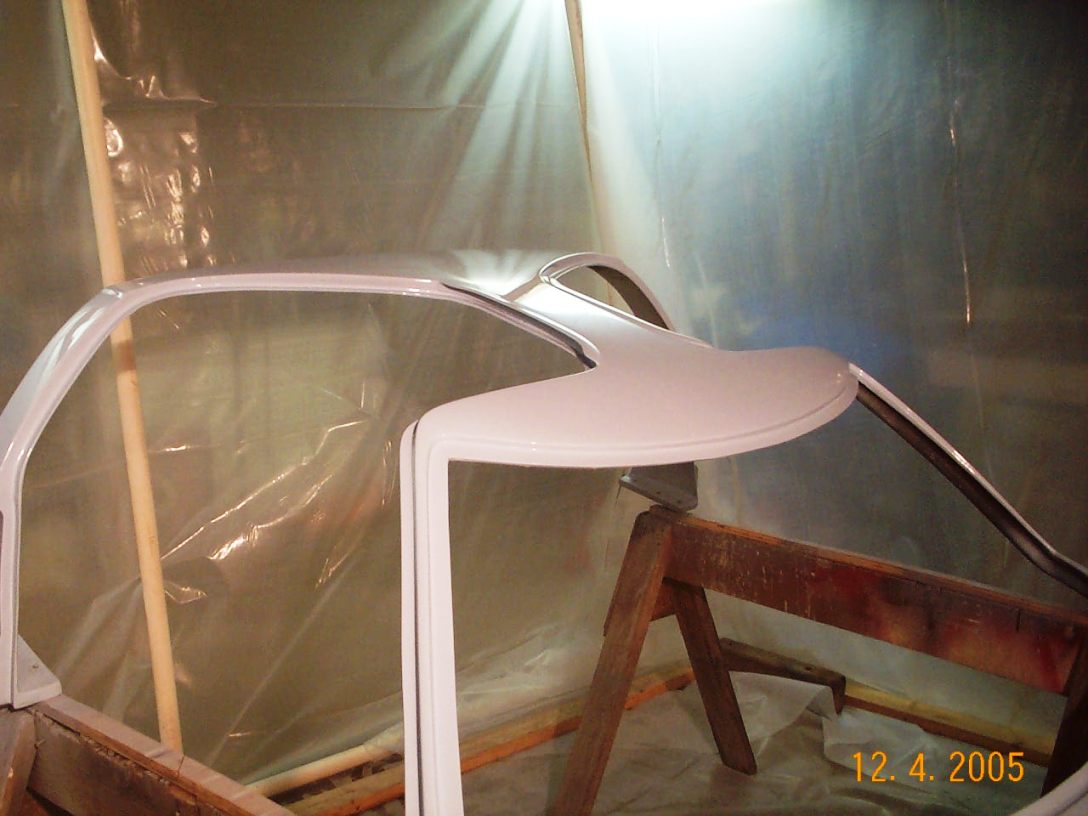

d

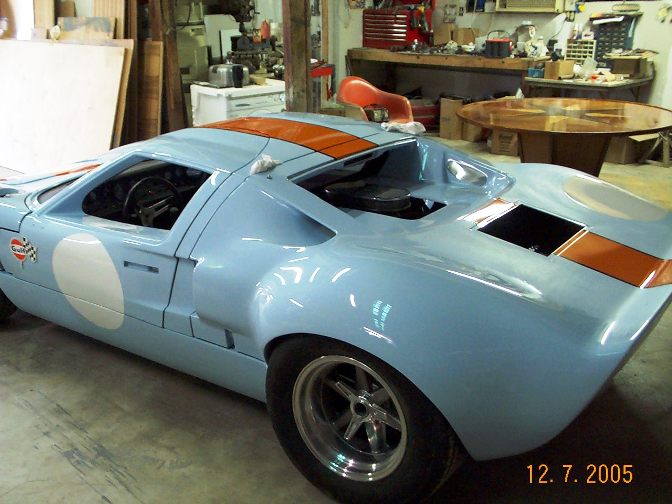

Installed body with one coat of clear to tape & line up stripes.

Why did you shoot a coat of clear before the base coat?
In what steps did you paint the body?
Tape the body to shoot the orange first, then tape the orange to shoot the blue and at last tape the stripe over the edge of blue and orange (this is what I plan to do).
Hope it is clear what I mean - hard to decribe especially after a long night with lots of beer. [img]/ubbthreads/images/graemlins/beerchug.gif[/img]
Regards Reinhard

Oliver, that's quite the compliment coming from you, thanks. I do refer to it as my living room but I can't put GT parts on the table as it belongs on the aft deck of a boat.
Allan, the gulf decal is stuck on with a little piece of masking tape. I have heard of people clearcoating over decals but it sounds risky to me.
Reinhart, the pics I took with a flash appear gray but it is powder blue. We first painted the blue and sealed with clear coat then taped everything exposing only the part to be painted orange then pulled the 1/2" tape to paint the dark blue stripe and that was clearcoated. Now everything gets sanded and more clear. We thought about doing it the way you describe but were afraid the blue would not cover evenly over the blue & orange.
Simon
