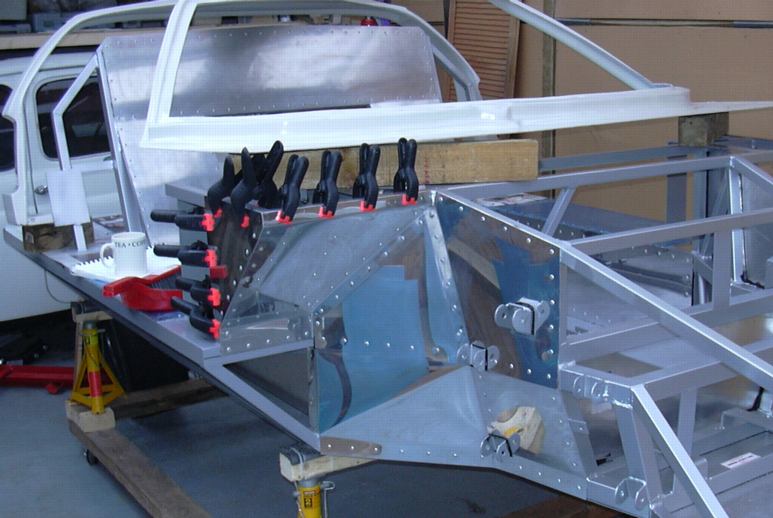

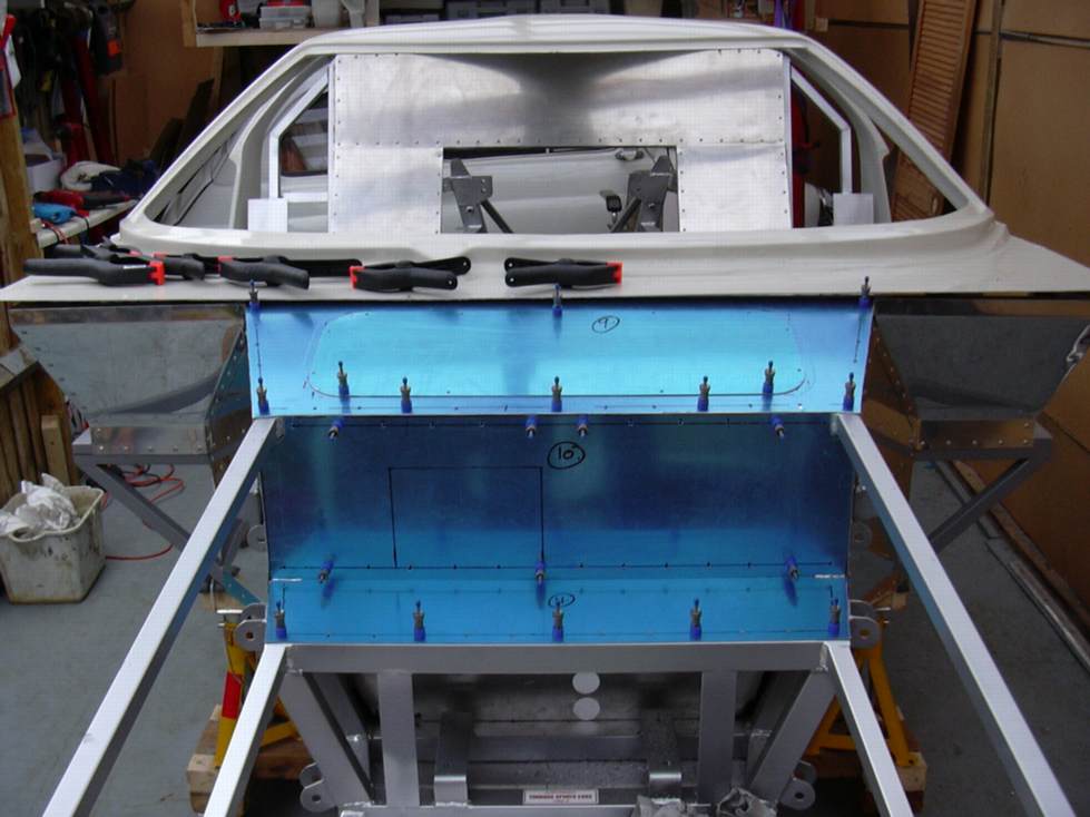

Another couple of pics : -
PDub is offline

Paul-
Your build is making great progress. The pictures have helped me to understand better how everything fits together.
I noticed the pictures of the rear bulkhead. The first picture showa it just laying there and the next shows it cut and fitted. When do you layout and cut the window?
How difficult is it to bend up the edges of the aluminum in the front area?
Bill D

You have to get the rear window in order to mark around it (1/4" larger to allow for the rubber seal)
Bending the metal I found fairly easy with a small folder (£30 in the uk) and some angle iron clamped in a vice. (wood will also do)
The angle iron is best as you have to do folds in various directions on the same piece.

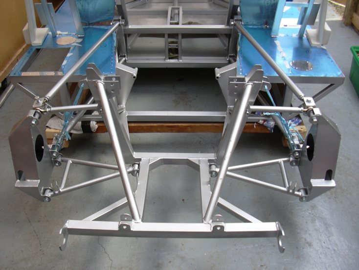

Front Bulkheads.

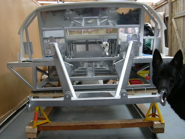

Rear - the muppet seemed impressed.

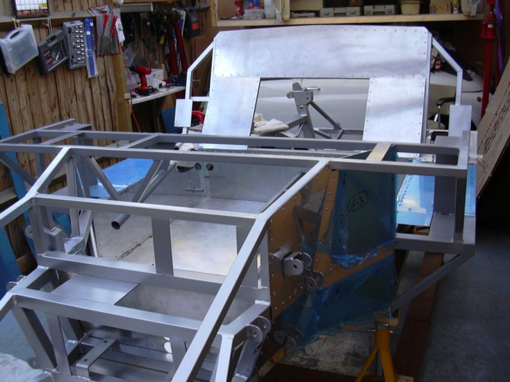

Suspension bits.

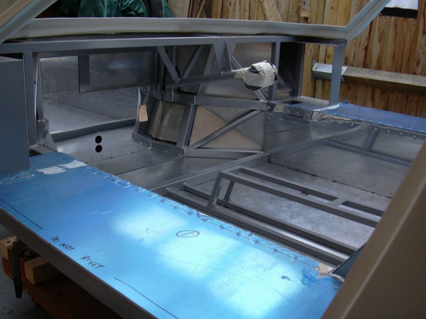

Great pictures. I have one request. Can you take a picture showing the inside (from the driver's view) of the last picture you posted?
Bill D

Try this - I'm not sure of what covers the wheel arch inside before you carpet it.

Paul-
Do you plan on paneling the inside to make for a smooth surface for the carpet? Hershal did, and his looked great from the photos he sent me.

I will cover the inside to get a smooth surface for carpetting ,after I've got some sound deadening in there - also I wan't to fit audio speakers and this is an ideal place.

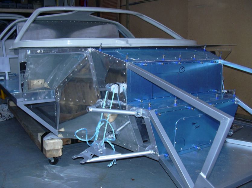

Test fit rear suspension.

Paul, love the blue springs or is that strings? [img]/ubbthreads/images/graemlins/grin.gif[/img] Seriously, it is looking fantastic.Keep the pics coming.
