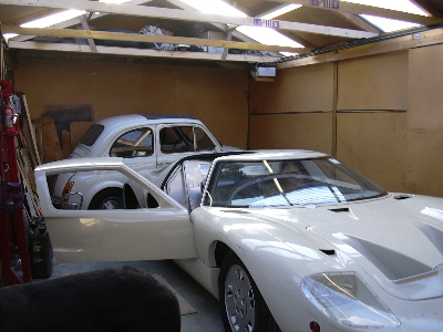

Re: PW Tornado Build pics
OK so I have done the Dukes of hazard thing - let me tell you it is a hazard in these cars. Dave morton suggested I step between the door and the A pillar but my garage roof isn't very high either so you have to watch yer bonce on the roof ! The easiest way at the moment is to crouch under the roof of the door and then do a 180 to sit on the cill and swing your legs in.
I started extending my garage today - and a re-roof higher.

Old 04-26-05, 12:58 PM   #125 (permalink)
PDub's Avatar
PDub
6 Tenths
Join Date: Jul 2003
Location: London, UK
GT40: Tornado
Posts: 647
Rebuilt the garage - a bit more space ........

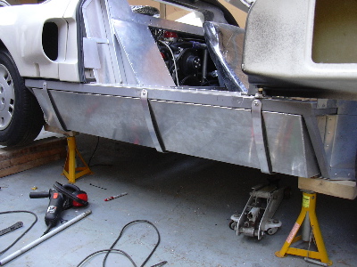

Been fitting/modifying the wiring loom so not many pics to post - most of its done now so onto the fuel system. Fuel pumps / filters / cutoff valves all fitted and onto the tanks.

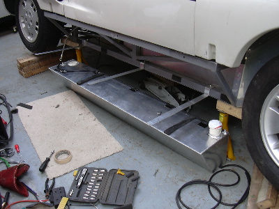

Fitted - there is foam between the tank and the chassis/brackets but this pic makes it look like there isn't any.

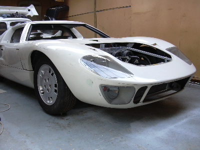

Change of plan on the lights - moved the indicator from the outside (gulf position) to inside the lower recess and made up some tinted lenses.
Now in the dash fitting / wiring mode.
PDub is offline
Old 06-30-05, 11:09 AM   #130 (permalink)
IanAnderson's Avatar
IanAnderson

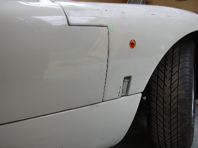

Old 07-02-05, 03:01 PM   #131 (permalink)
PDub's Avatar
PDub
6 Tenths
Join Date: Jul 2003
GT40: Tornado
Posts: 647

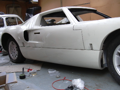

The lower recess will be blocked off for SVA (Tape over the light cover) and another indicator mounted in the headlight recess temporarily. I don't think there is any way of mounting an indicator in the lower recess that will pass UK SVA. I'm about to mount the side repeater above the body catches that I have just mounted : -

Old 07-03-05, 06:30 AM   #132 (permalink)
Ron Earp's Avatar
Site Administrator
Posts: 3,925
Paul, it looks nice! I have just one suggestion though on your tank mounting - you might want to take the time to weld some "ears" about 1.5" wide and 6" long on the outside of the tank parallel to the front and rear down tubes that are in front of and at the rear of the tank. These ears would overlap on the downtubes. Then, you could drill holes in the ears, holes in the down tubes and secure the tank firmly using bolts and do away with the three folded straps that hold it in place now. It would be a little more secure and eliminate any virbration that might occur with the compressed strap method.
It might already have something like that though.
R
Ron Earp is offline
Old 07-03-05, 08:04 AM   #133 (permalink)
PDub's Avatar
PDub
6 Tenths
Join Date: Jul 2003
GT40: Tornado
Posts: 647
Ron, I considered this when i was designing the tanks but my welder man thought that any sort of "ears" would create a stress point on the tank. The straps I have used have foam (compressed) all the way around the tank so it is held firmly in place - they are very tight on the tank. It's a bit hard to see from the pic I posted.

Old 07-06-05, 11:26 AM   #134 (permalink)
PDub's Avatar
PDub
6 Tenths
Join Date: Jul 2003
GT40: Tornado
Posts: 647
Side repeaters ,body locators and catches fitted. The side repeator is from a peugeot 505.

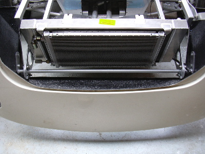

Aircon radiator fitted....

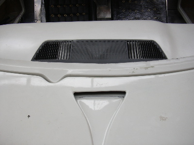

Rear vents arrived - fitted this afternoon.

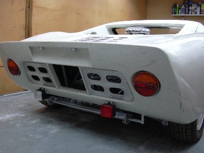

Old 07-25-05, 05:24 PM   #140 (permalink)
PDub's Avatar
PDub
6 Tenths
Join Date: Jul 2003
GT40: Tornado
Posts: 647

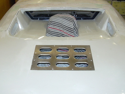

Fitted the rear vents and fog / reverse light for SVA. I will move them once I am through it.
