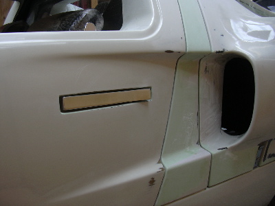

Fitted the door handle recesses and then the handles - glad that is out of the way. You can also see some of the highly enjoyable body prep I have been doing. Now onto fitting the central locking servos in the doors. I may even change my wooden steering rack this week !

Your bodywork seems to fit really well out of the box. I am astounded as the GTD was way off - especially the last picture of the door/air scoop. You just lopped about a quarter of the build time off [img]/ubbthreads/images/graemlins/grin.gif[/img]

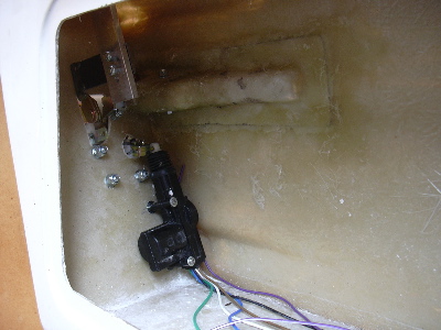

The fit wasn't so bad but you have to bear in mind that I have spent a few weeks building up areas and sanding. Fitted the central locking the other day.....

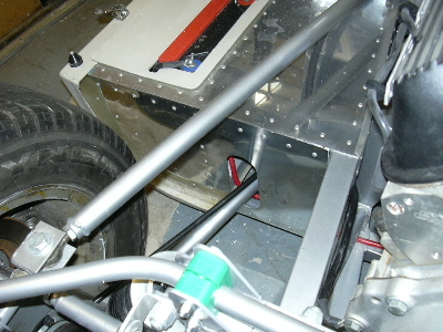

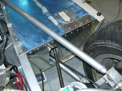

Front anti-roll bar....

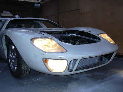

The electrics all seem to work....

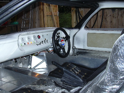

Finally have replaced the wooden rack and fitted a normal one !
Steering is all in and started on the dash switches - SVA compliant positions, for the moment. Fitting / plumbing the aircon at the moment.

looking really good. I like the idea of central locking. What units did you use? Was it hard to sort out and fit?
Sorry for all the silly questions!!
Murray
MGNut is offline
Old 08-05-05, 02:19 PM   #149 (permalink)
PDub's Avatar
PDub
6 Tenths
Join Date: Jul 2003
Location: London, UK
GT40: Tornado
Posts: 647
Re: PW Tornado Build pics
The remote central locking kit came from : - http://www.diygti.com/
about £30 as I remember.
Was really easy to fit - it comes with a prewired loom that you just have to plug the correct coloured cables together. It came with 4 actuators so I removed the extra cabling from the loom. The only tricky bit is getting the electrics into the doors - I used the rubber sleeves off a metro GTI door !

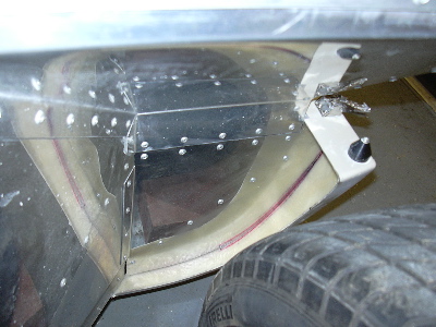

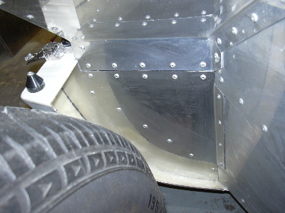

Final front wheel arch panel fitted.....

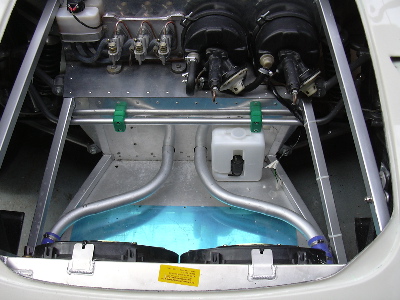

Last couple of ally panelling pieces .... Engine bay cill end.

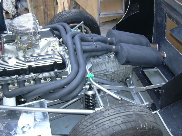

Not much done this week as the car has been at Tony Law in Leeds for a full crossover system in mild steel - Paul there has done an amazing job on it. Need to decide what coating to get put on it , ideas welcome - in the UK though.
Anybody tried : -
http://www.zircotec.com/

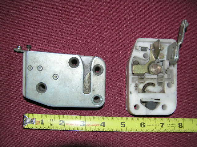

Paul, very interested in this central locking pic. Can I ask, are you using these door locks / catches in the picture below? If so, how do the central locking motors "drive " the catch - or do you have a separate deadlock pin through the door?
