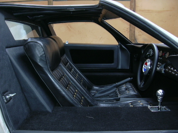

Interior 2...

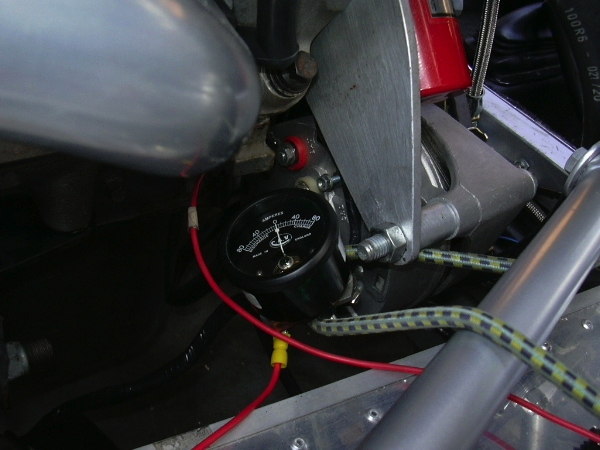

Fitted an ammeter so I can keep tabs on my charging system.
Need to work out how to position some mirrors so I can see it from the drivers seat. [img]/ubbthreads/images/graemlins/grin.gif[/img]

Fibre optic material might be the answer--instead of mirrors [img]/ubbthreads/images/graemlins/grin.gif[/img] [img]/ubbthreads/images/graemlins/grin.gif[/img]as long as the ammeter has background light and a magnifyer on the other end----seriously [img]/ubbthreads/images/graemlins/tongue.gif[/img]
That altenator mount needs to be more substantial-ie plate both sides or boxed -- lots of flexing will occur otherwise.

If thats a header pipe that meter won't last an hour. But then you temp.installed it there for testing the charging system, right?......really.....right?

Busted !!!! A friend of mine (Geoff) came over this afternoon and brought his testing equipment to see if my alternator / regulator were working e.t.c. After trying his meter first ,we did a secondary test with his ammeter that is going into his 40's dash - thought it worthy of a picture as it looked a bit ridiculous hung on the back of my alternator. Anyway all is well with my system just doesn't do much at idle rpm's.

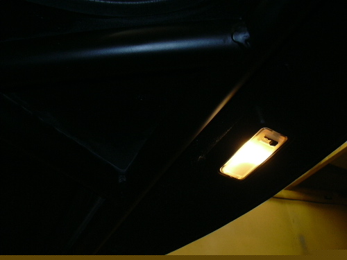

Managed to get cables through the inside of the roof for an interior light.

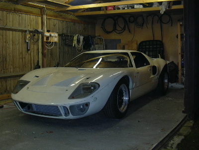

SVA a week today - nearly ready now.....

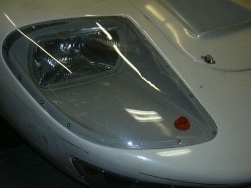

One thought, you may want to remove the headlight covers for SVA, as I think this would not pass SVA not being E marked...
Brett

So had the test today and it went really well. The guy testing it was very fair and allowed me to cable tie a few things and mod / remove a few others.
It failed on a few minor items : -
1. having removed the indicator in the lower recess, the other bulbs now flash too quickly so I need to add a resistor or fit higher wattage bulbs.
2. fit some mesh over the nostril openings - so nextdoors cat can't get in there ! (Geoff didn't see why this would be a problem !)
3. Fit some mesh over the front clip opening in front of the rad for stone protection and also in the rear clip side intakes.
I call that a result - <font color="red"> </font> YABBADABBADOOOOOOO !
