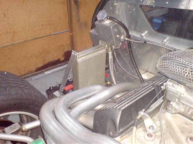

Been very busy at work the last few months but did get a few bits on the car added or uprated. First was the gearbox oil cooler mounted in a kind of saxophone ! Scoops air up from under the car and forces it through the cooler. I used a diesel fuel filter off the UN1 drain hole and then pump through the cooler back ontop of 5th gear at the rear. The pump is mounted on the round angled chassis tube with some mounts I welded inplace for it. The engine bay is filthy at the moment as I have had overheating problems and the system keeps puking onto the road and spraying everything in sight ! Turned out to be a blown head gasket and also a problem that rerouting my coolant hoses had introduced - all now sorted so I'll clean her up a bit.

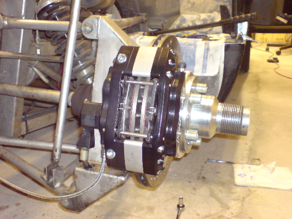

Re: PW Tornado Build pics
The original Granada brakes that I fitted were ok on the road but soon faded on the track so I've replaced them with Hi-Spec Monster 4 pots on the front with 335mm drilled discs mounted on Alluminium bells. The Billet 4 handbrake rears are ordered but have yet to arrive. They have allowed me to remove the brake servos as having much bigger pad area and lots more leverage on the discs. I've not been on the track with them yet but just on the road they are a huge improvement.

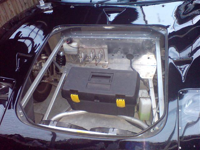

Having lost the servos off the front bulkhead I'm debating making it a more permanent storage area for long trips. Temporarily I have mounted a toolbox that i got in Homebase - holds enough tools but still no lugage. I'm tempted to remount the pedals on the floor inside the car which would then give way to panelling this area in properly from the radiator back. The electrics loom is now in a bit of an odd place coming out the upper bulkhead were the servos originally were so I may reroute this lower down.

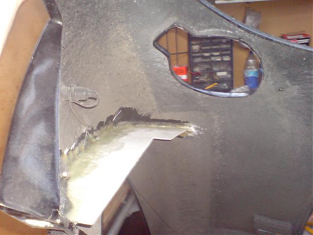

Weatherproofing is not ideal on the 40 especially where the front tyres spray water off the road into the door hinge area. I have just started modifying the front clip to try and stop so much water getting onto the hinges. I will try and get a rubber extrusion to seal the edge of this new piece I've glassed in against the sides of the ally bulkhead.

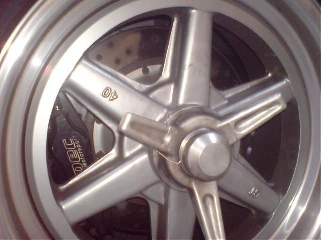

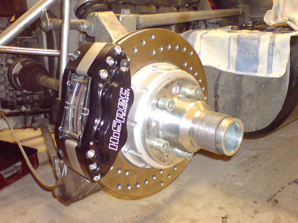

New Hi-Spec rear brakes with the built in handbrake mechanism. The car stops really well now but it did take a long time for Hi-Spec to make these !

Looks great Paul. Just a question - do these brakes mean you have to run 17's or is it the (lack of) tyre situation, or just personal preference?

On the rears I think you would get away with 15" rims - I haven't measured but know people with the 300mm + Billet 4's on the fronts (Same as these rears) I went for 17" rims on purpose as I wanted to fit the biggest brakes I could get - current fronts are 335 discs with monster calipers. I prefer the look of the 16" rims but tyre choice for these is/was no better than 15" at the time when I bought them.
