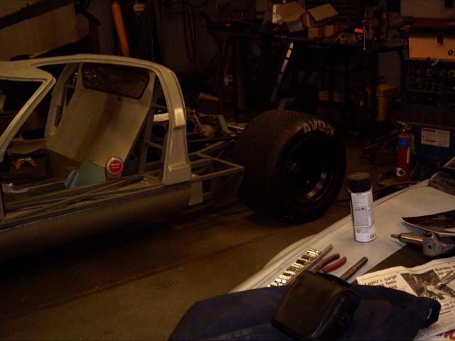

More;

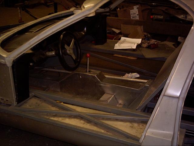

And last but not least;

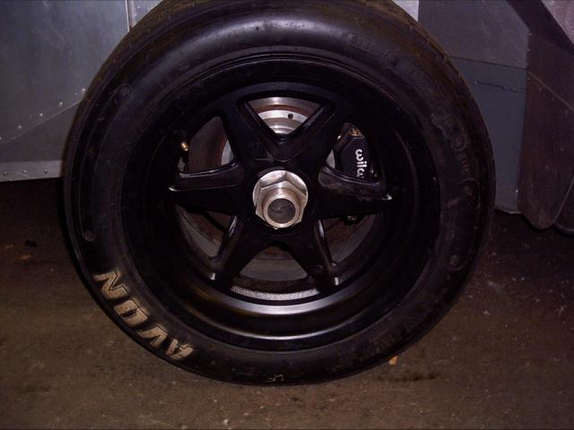

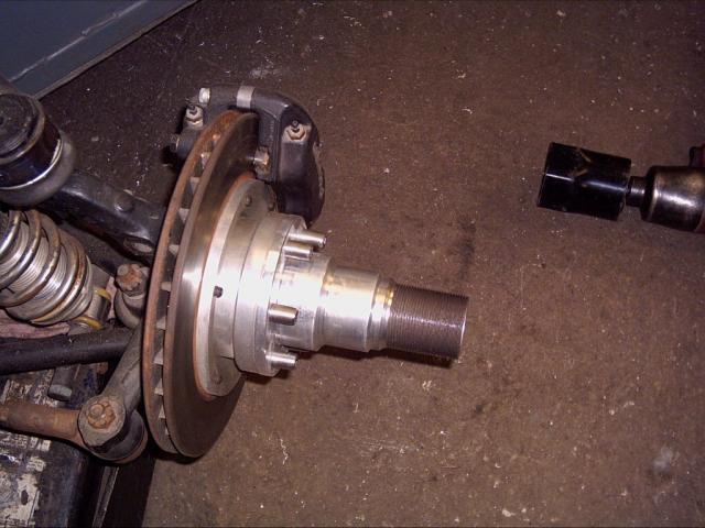

Here are some photos of my completed front wheel mounts to take the 15 X 10 fronts.
ID:	26541   Click image for larger version

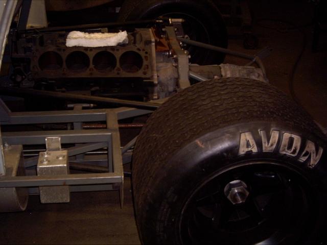

Richard
My uprights are my own design. I wanted the upright to fit into the wheels I am using, and provide as much stability as I could get.
They are 6061 alum, and use a ford bearing and hub.
My goal was to get my lower wishbone and transverse upper links as long as possible, while keeping with the 56" track width...everything works, and the units are strong and very light.
Here is a photo of the upright installed with just the hub mounted.
Phil
Name:	September 2004 084.jpg

Bill;
Good to hear from you. Don't know about bringing my chassis, but I will be there for sure. Meanwhile here are some photos I promised, progress is a little slow as I am on a big project now and happy to have work so "nose to the grindstone" as they say.

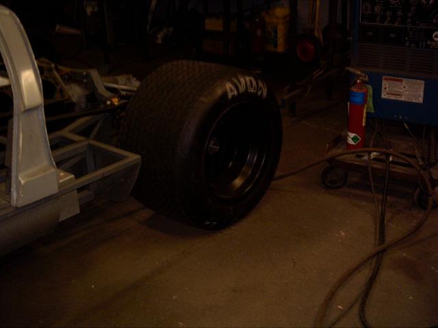

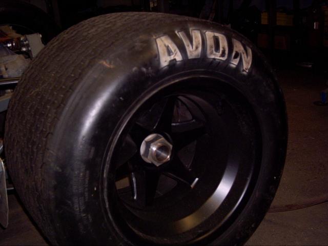

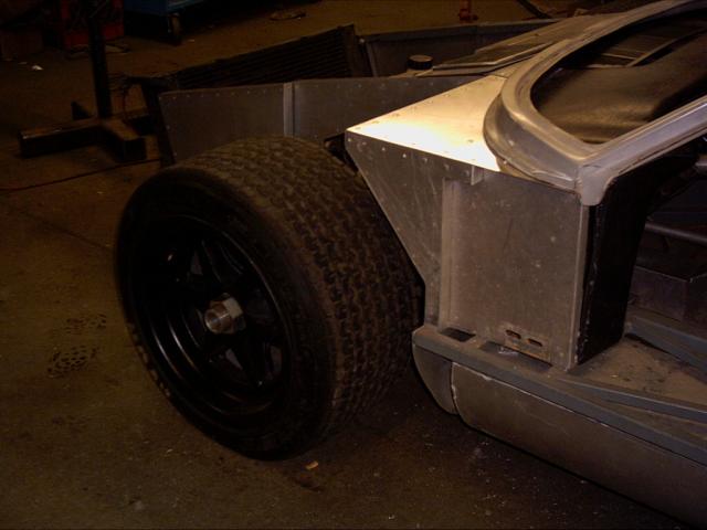

Here are photos I took sunday, wheels and tires are mounted, and I am working to complete panels and then on to some wiring. Brake pipes are run, need to complete mounting the rear brakes and flex lines to all 4 wheels.
Bill, I will give you a call in the next few days.
Phil
Name:	gt photos 010.jpg
ID:	35741   Click image for larger version
Name:	gt photos 015.jpg
ID:	35742   Click image for larger version
Name:	gt photos 017.jpg
ID:	35743   Click image for larger version
Name:	gt photos 018.jpg
ID:	35744   Click image for larger version
Name:	gt photos 019.jpg

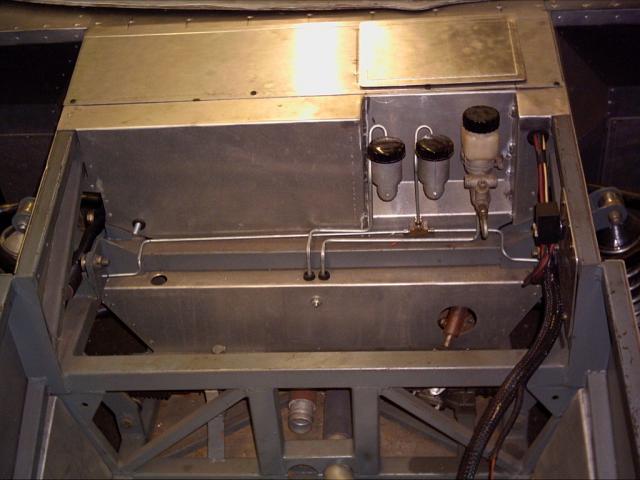

A few more for good measure.
Name:	gt photos 024.jpg
ID:	35746   Click image for larger version
Name:	gt photos 026.jpg
ID:	35747   Click image for larger version
Name:	gt photos 020.jpg
ID:	35748   Click image for larger version
Name:	gt photos 016.jpg

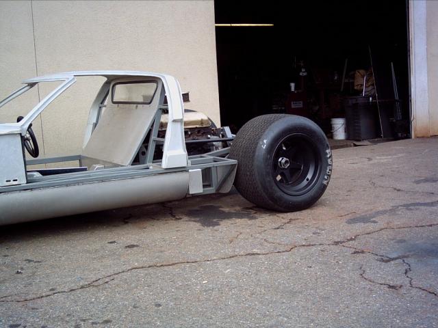

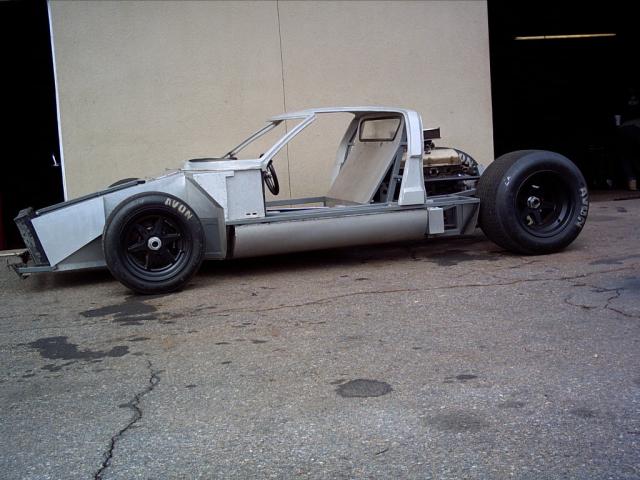

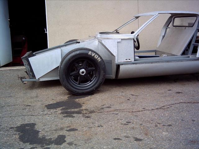

Back to my passion. A little spring cleaning and making space for the important stuff.
Finally got my adapters sorted out and wheels mounted correctly. I need to start fitting up the center section and then doors. I should have my rear decklid soon and can't wait to see how the tires fill the wheels arches. Hopefully I can progress faster than I have lately, and post some more progress. Took a few photos outside today and I think it sits about right.
Phil
Name:	gt photos 002.jpg
ID:	37490   Click image for larger version
Name:	gt photos 007.jpg
ID:	37492   Click image for larger version
Name:	gt photos 006.jpg
