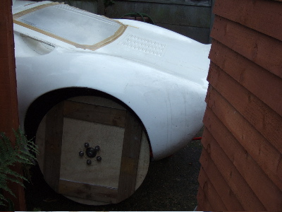

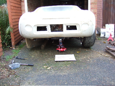

Should be easy - jack up, unbolt remove and fit the other set.
Reality was Jack up remove the rears offer up the Granada ones and "Oh Sh%t" the granada offset means the nner tyre wall rubs on radious arm.
Bugger it all we needed was something to allow us to roll my car back into the garage when Paul's was at SVA.
Decided if we spin the car - swap the front wheels (they worked and fitted)
sttach a chariot wheel in timber - Roll it into the garage, remove the last rear wheel and place on axle stands.

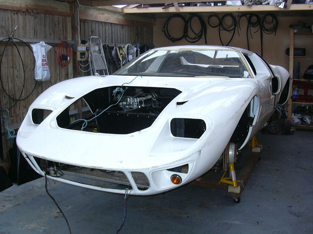

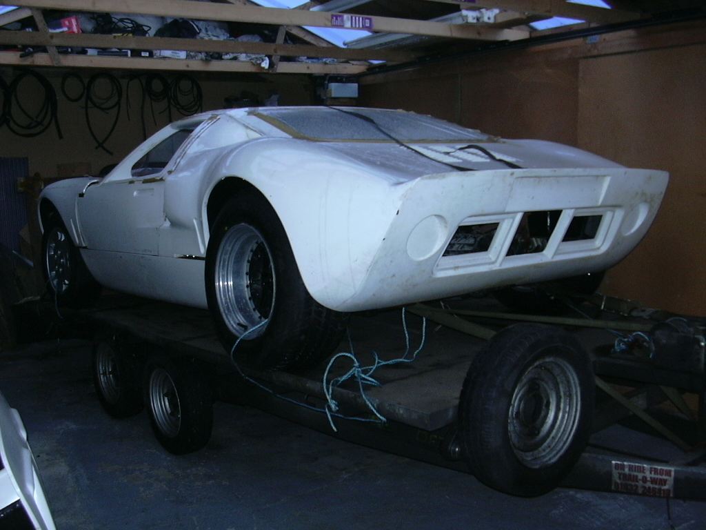

Got to Paul's As usual it rained when this car came out the garage

Off the trailer and ont the build dolly

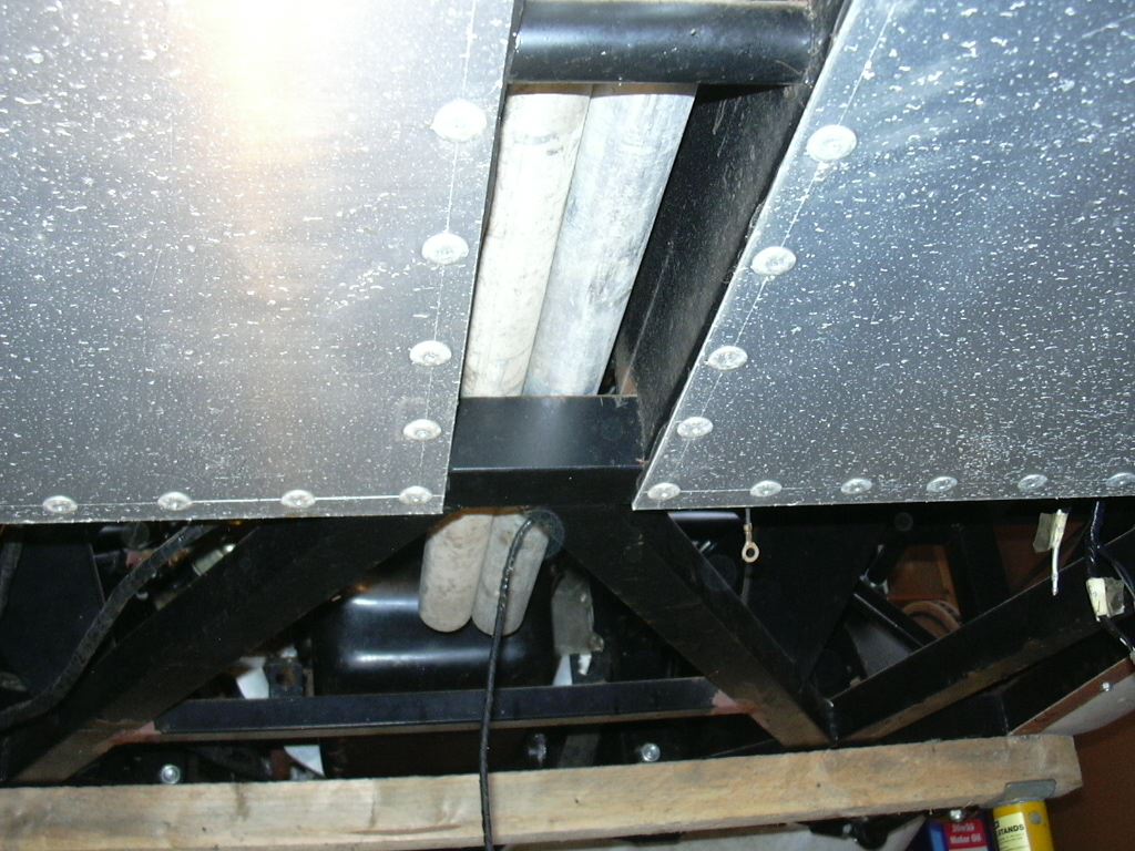

the tunnel is open under the car makes access easier

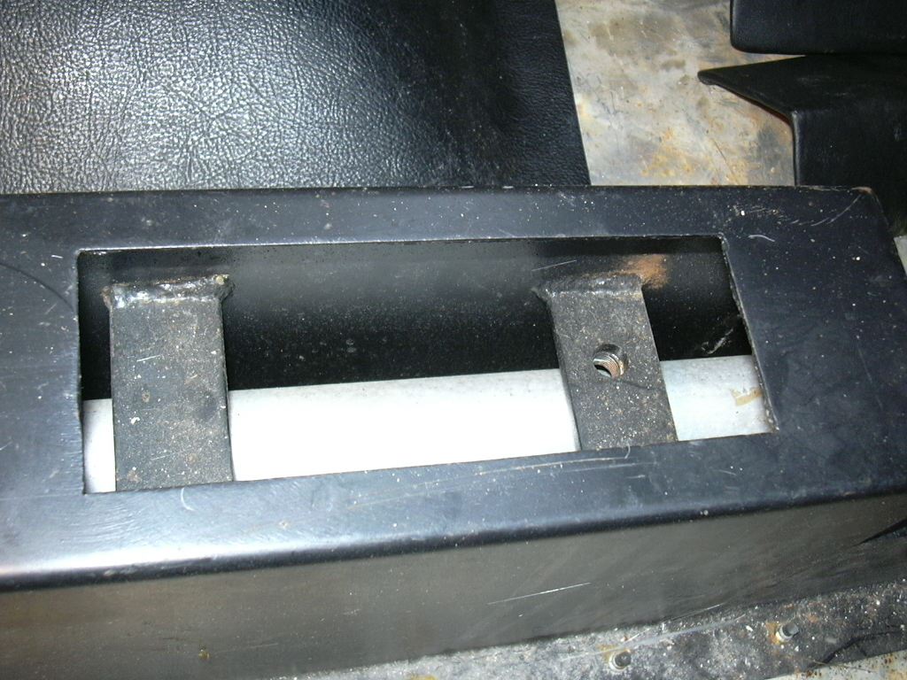

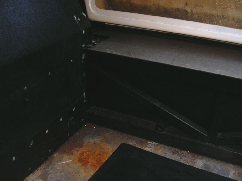

Pictures for SVA re Seat belt mounts (If any one is reading the SVA will want to confirm how the Belt brackets are mounted - photo evidence is acceptable)

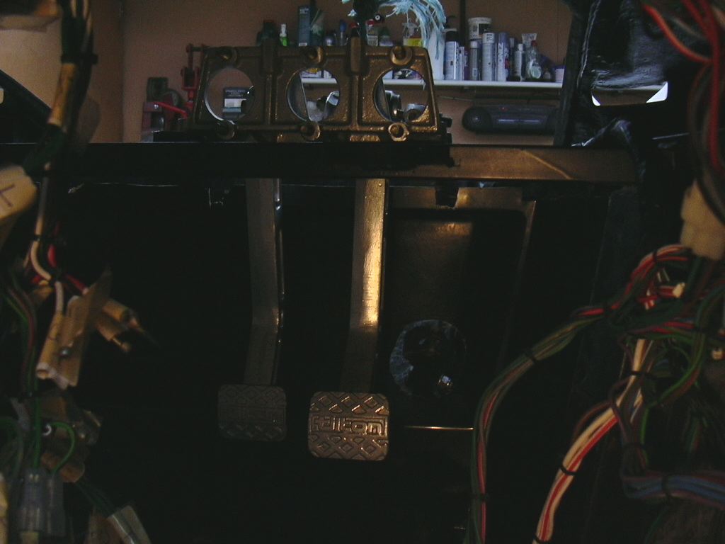

Under Dash facing front

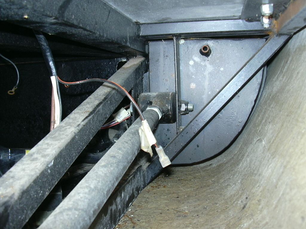

Re: DAX Build Up
Up side pod from rear to "fitted fuel tank" Spot the mistake - It was a car ordered with EFi and there are no returns. First job is to remove them and get returns fitted.
Also had to remove the fuel filler caps as they stand proud of the body and will Fail SVA
These jobs took the best part of a day!

Re: DAX Build Up
The Dax radius arm? in the above photo can be seen as one of the big differences to oher 40's as they go almost straight forward and inside the side pod. (Tornado and GTD go inboard close to the engine.
The dust is from 15 years of build so far (previous builder 14 years and in my posession 1 year,
Seriously considering at this stage that I will link both tanks together in the engine bay (Say 1/2 inch across the bay) draw from 1 tank and return to the other - a damn slight easier than returning to the tank being drawn from.

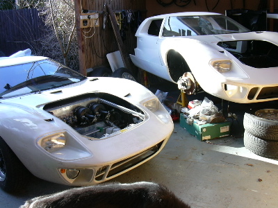

DAXNADO Paul's Tornado nostril on the Dax Amazing difference in thickness - the Dax is definately not a lightweight!

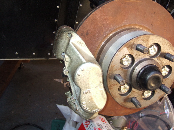

Re: DAX Build Up

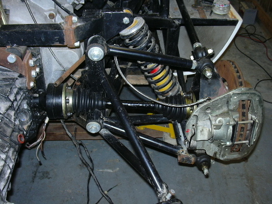

Front brakes AP units that bolt direct to Granada hubs
(I was advised off a Porsche 944)

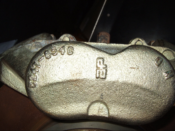

Re: DAX Build Up
Has any body used this caliper on a 40 and are they up to the job?

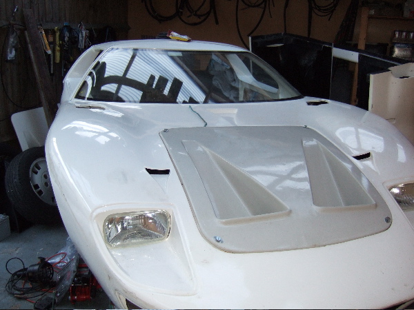

Re: DAX Build Up

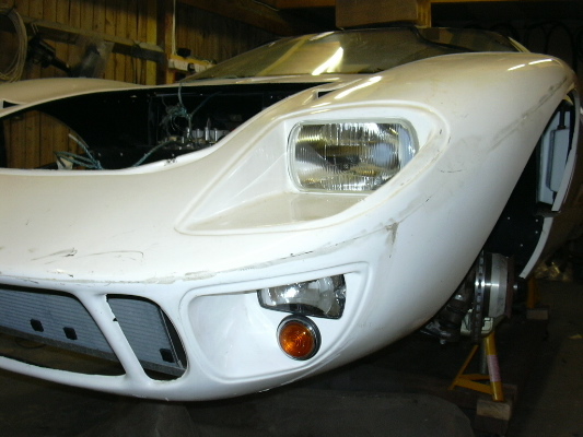

Front lights, indicators (to be removed for SVA) and driving lights fitted
