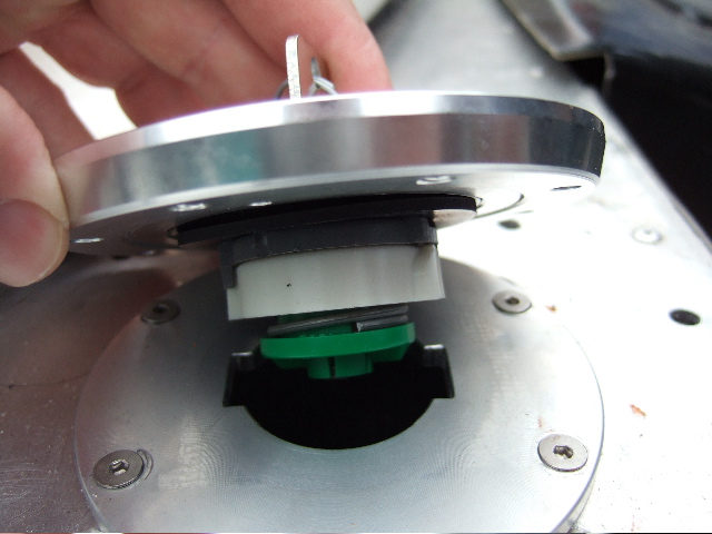

The witing loom has been fitted and modified behing the dash and everything clipped back for the SVA - not much to photograph excepy a lot of coloured spaghetti. Also waiting for some bits to be made up - gearchange, fuel cap holders etc BUT work coninues.

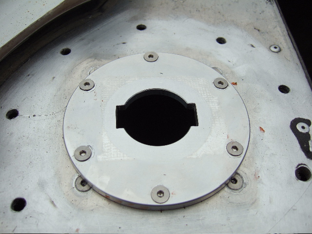

First pictures - to get around the "normal" fuel filler caps that stand proud and would fail a SVA snag test I bought from E Bay 2 "Gilf GTi Mk1 dress up fuel caps" They arrived and then had to get them to fit the car so 2 donuts were made from Ali about1/4 inch thick. With a cut out for the cap.

The ebay caps fit the donut

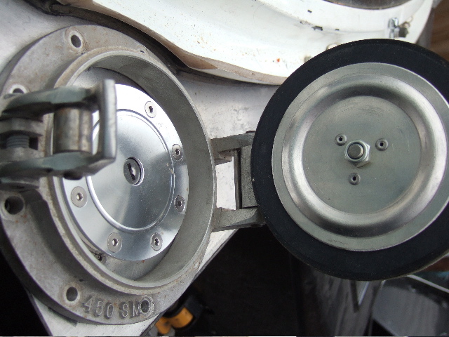

Re: DAX Build Up
The reason we did not just fit aerocaps is the tanks have a breather that goes to a flange at the top pf the filler pipe just below the new donut - the aerocap ones do not have the breather.
And the GT40 caps fit over the whole lot (clearance is tight but they fit

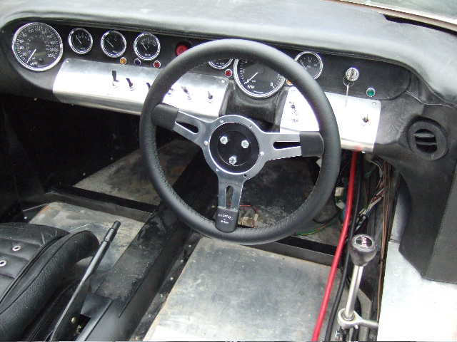

Bugger the last photo should have been rotated.
The steering wheel and gearstick trial fitted

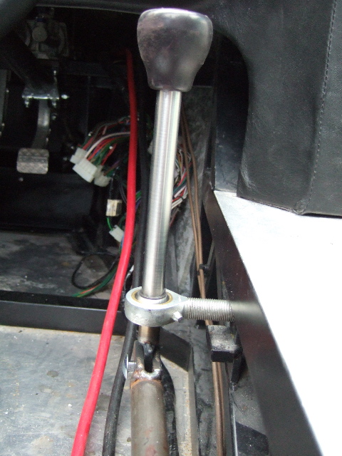

Gear Stick mechanism (Mounting bolt needs shortened)

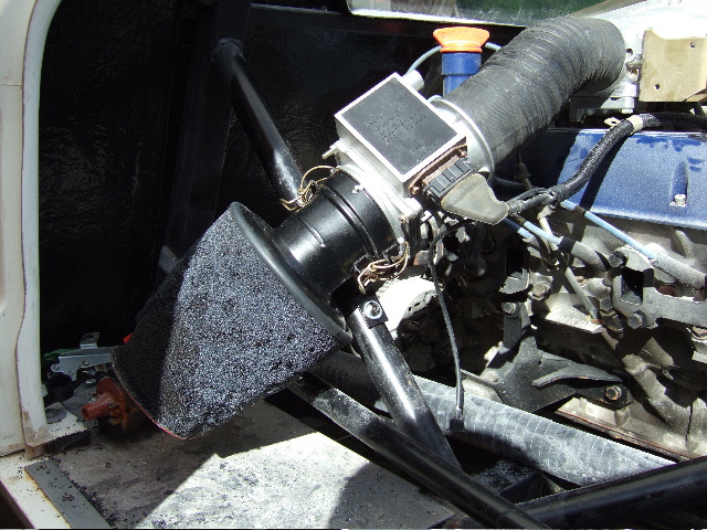

Saturday 01 April the airfilter (innards from rangerover) were mounted o pick up air from side scoop - 15 years will do this to an air filter element!

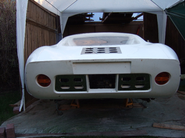

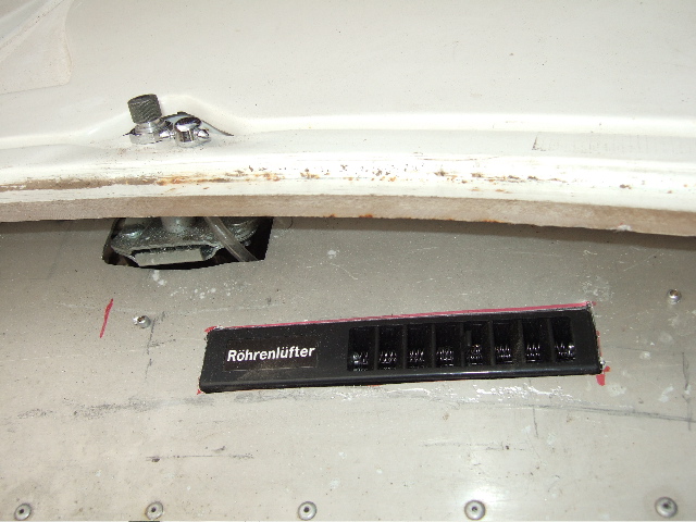

Finally the rear vents have also been fitted - purchased from a local engineering firm in polished stainless steel.
More to follow

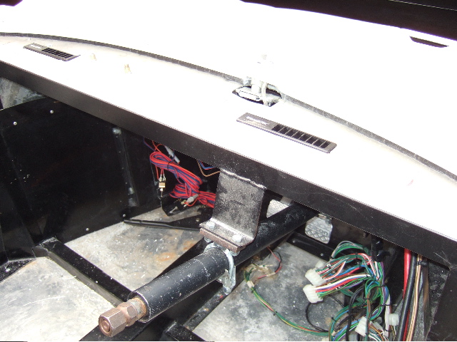

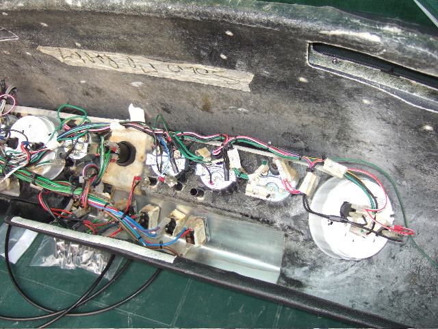

In the meantime when I polished the wheels, Paul marked out and cut 2 demister holes in the Gax dash amd fitted vent coners - then fitted 2 elecric demister units .
first photo rear of dash neat wiring

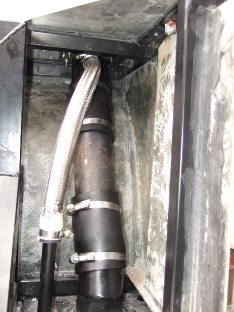

Re: DAX Build Up
When the dash was out I tookthis og the Dax fuel filler pipe and tank breather - under the new fuel caps pistured yesterday

Two demisters fitted (not yet wired in)
IanAnderson is offline
Old 04-02-06, 04:59 PM   #59 (permalink)
IanAnderson's Avatar
IanAnderson
Gold Supporter
Join Date: Nov 2003

Re: DAX Build Up
Close up of demister heater outlet
