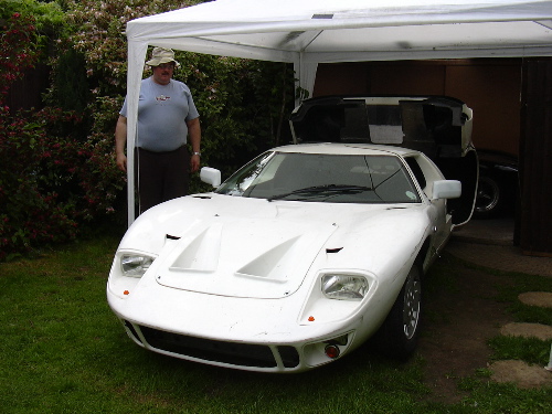

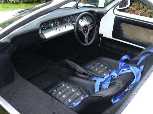

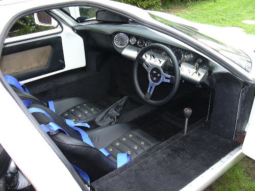

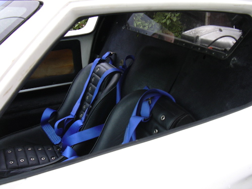

What a difference a few days make!
First a view of the car with screen fitted - perfect fit and now with wiper and squirter
Next a view of the SVA belts (need longer neck bolts)
Interior from left
Interior from right
All of a sudden it looks like a functioning car - now where are those wheels? Paul due to get his new set this week and I'll get mine back on and align lights etc. Hell I'm excited!!!!!!!!!!!!

Ian, Plastic Bulkhead window ??
wealdenengineer is offline
Old 06-05-06, 12:31 PM   #85 (permalink)
IanAnderson's Avatar
IanAnderson
Gold Supporter
Join Date: Nov 2003
Location: Heathrow, London, UK
GT40: Dax 40 Mk1 (Rover3.9EFi)
Posts: 1,318
Rep Power: 18 IanAnderson is a jewel in the rough
Frank
Yes it is perspex / plastic / acrylic (Sorry not up an how the differences can be checked)
Likewise window on rear clip is plastic / perspex / acrylic
