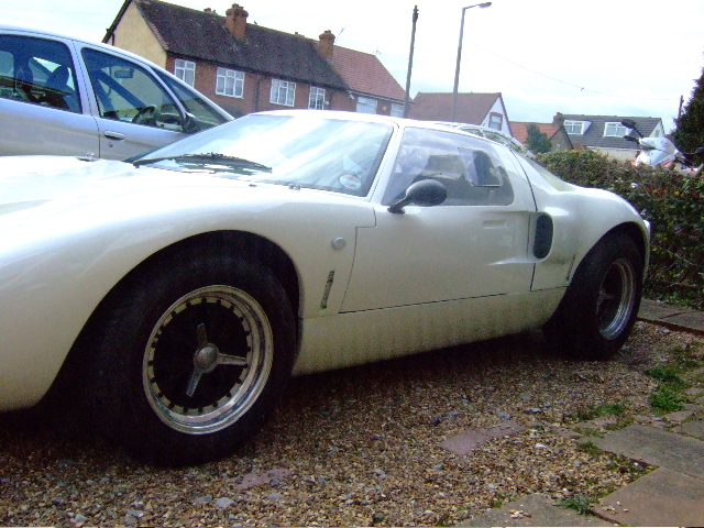

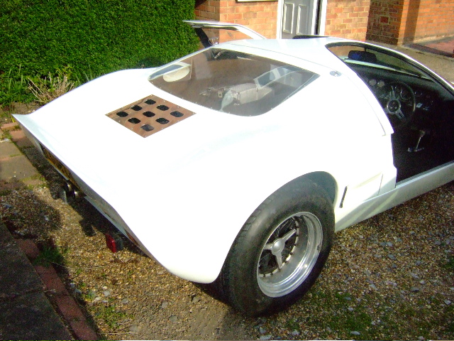

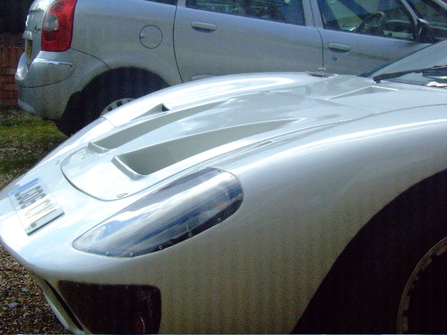

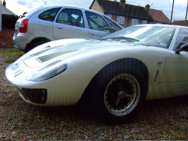

Collected the car and WOW what adifference 3 weeks at the paint shop has made. It is better than I expected and he pictures do not really do it justice.
I managed to crick my back today so could not get out to take petter shots

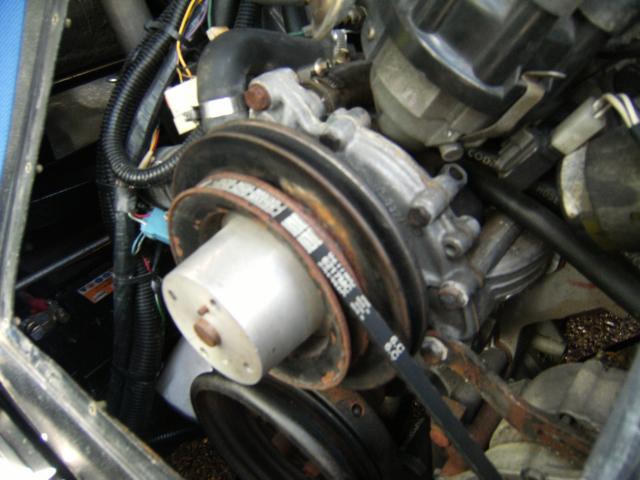

Found a water pump it is the P6 variety (to get a short nose)
Needed to modify the mounting holes as a non P6 pulley is used to line up with the crank pulley.
Finished at 10:30 last night so did not start it as the neighbours would have had a fit.
Tonight I'll start and see if it is sealed!

Ran up to temp and spewed water everywhere
Simple fix - I had missed on of the hose clips!
Tightened and tan to temp - fan cycled 4 times and temperature steady as a rock.

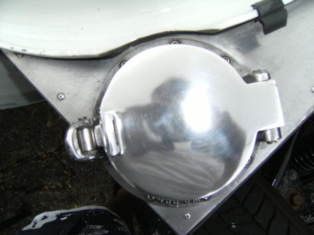

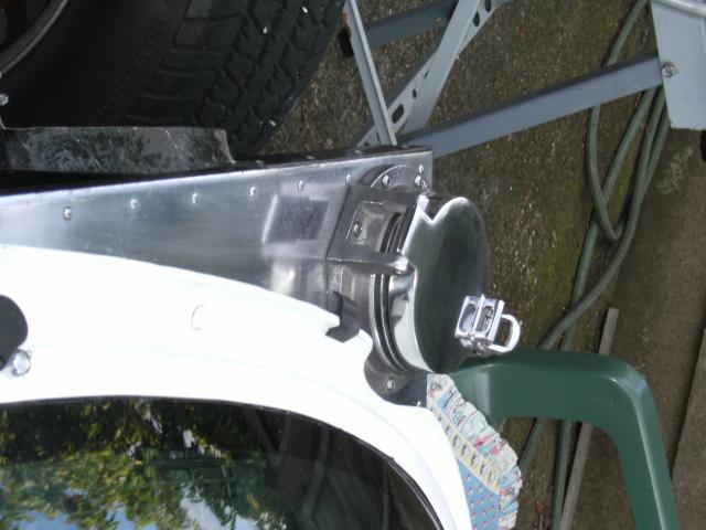

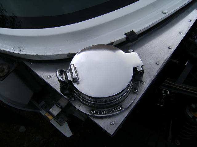

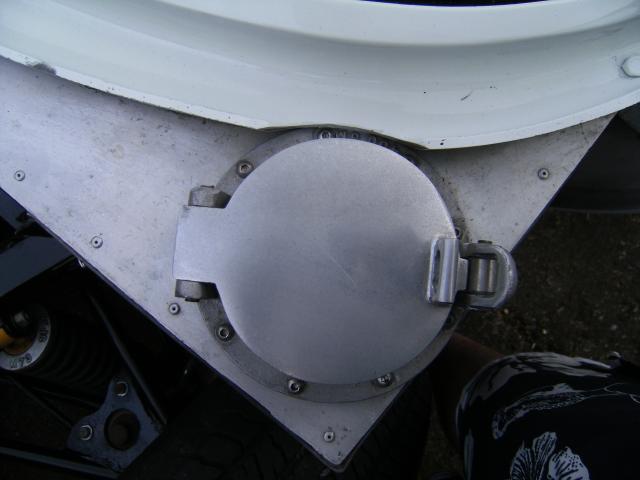

Sme pics of the work done in the last couple of weeks
Polished 18 years of corrosion off the fuel fillers and ali surrounds

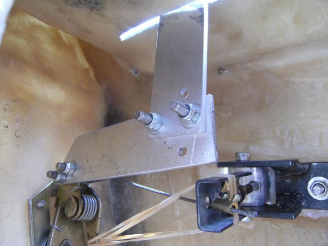

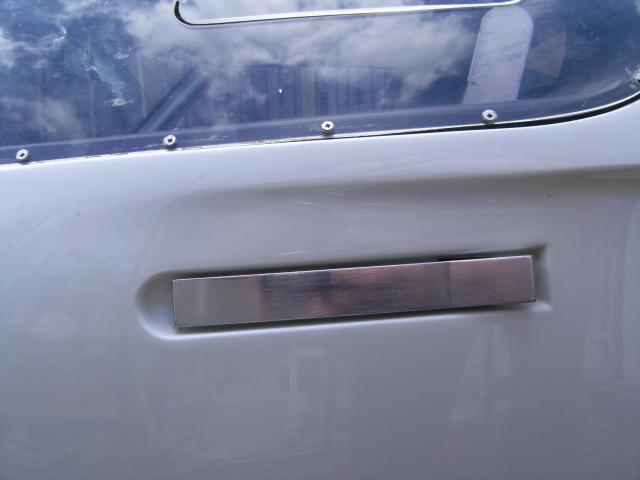

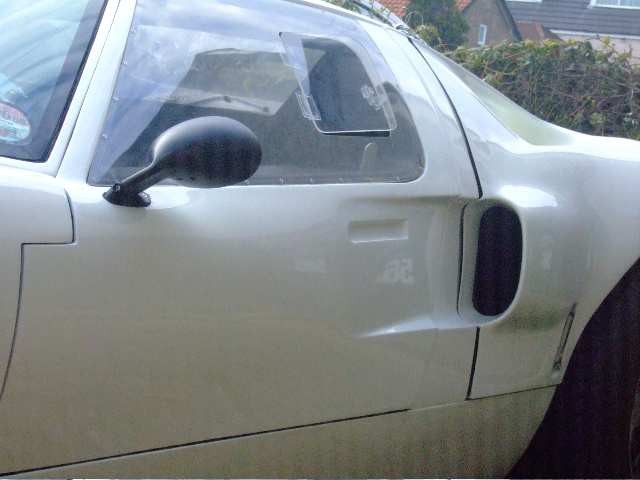

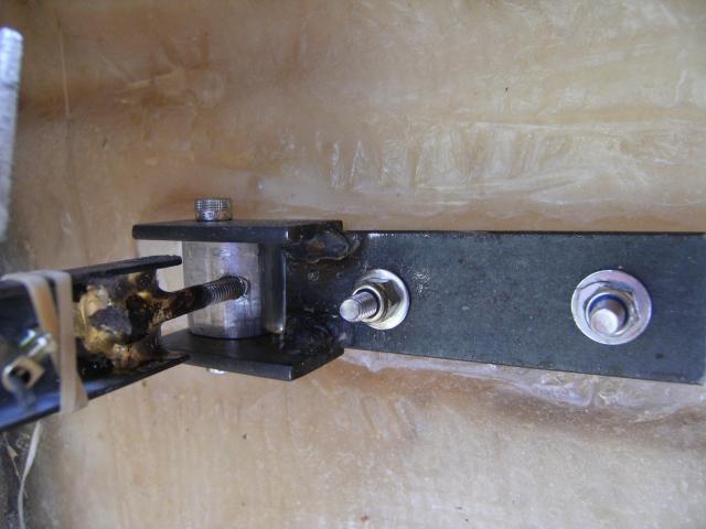

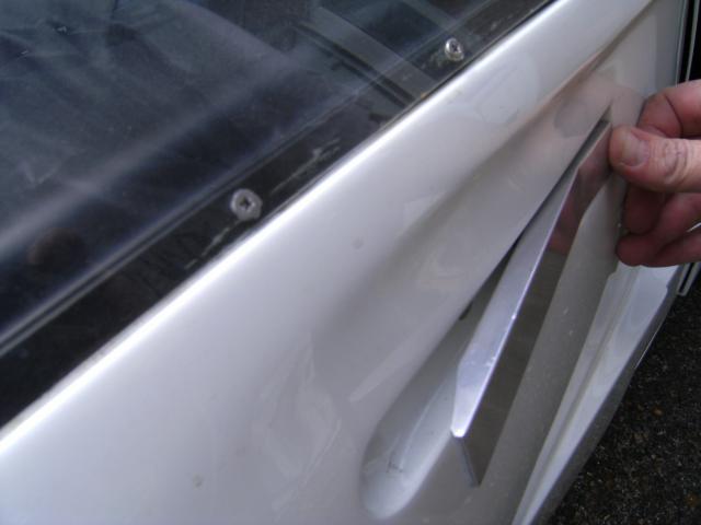

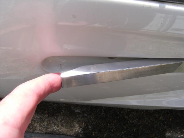

Door handles fitted and mechanism made to attach to inner handles. These use normal bearclaw catches. (not those from a Mini)
The rubber band will be replaced by a spring to hold the outside handle closed
Handles made from Ali bar - shaped by an enthusiast Club member
2 bilts through the fiberglass hold the hinge bracket in place
Inner handle opens by pulling forward and returns to up position when closed.Locks - not yet.

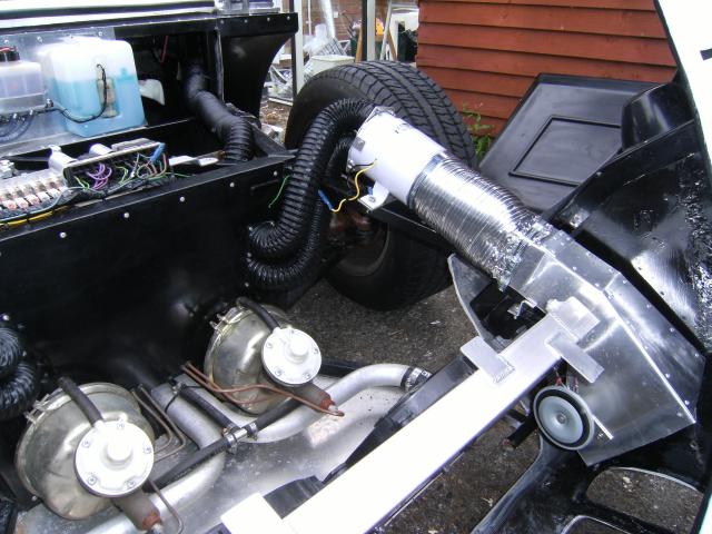

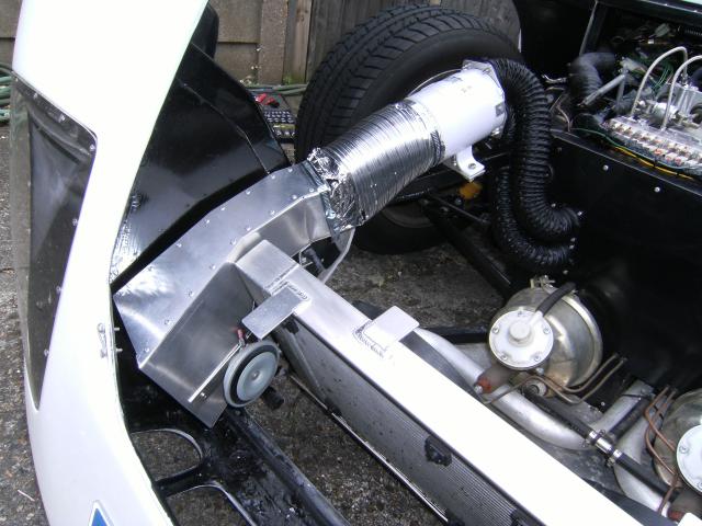

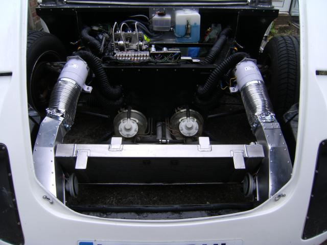

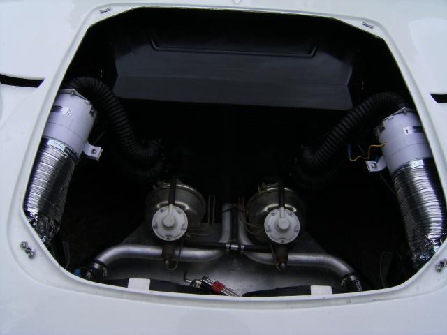

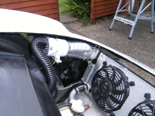

My "tight arse" air system AKA ram air
Ducted from the brake duct inlets next to the rad
Over the mounts for the Radiator
Through a duct from rectangular to square
Through a bilge pump on each side (250cfm 4 inch)
Into 2 by 2 inch duct pipes per side - oneper side to the eyeball vent and the other in footwell area.
Fans are independently switched
Should not be necessary when moving but will give a good flow when stationary

Hi Ian
I like the way you've done the door handles, as I never liked the idea of the pivot bolt for the handle being into the fibreglass, as I've seen on many other kits
Good luck with your trip to LeMans
Regards
Andy

Nice job Ian,
looking forward to seeing it in the flesh soon.
Agree with Andy on the doorhandles, quite robust.

Fans kick in on the thermostat at about 92 - 93 and turn off again about 87 -88
Today I went for a drice to Tony Hunt's for lunch and to drop of tickets for Le Mans Got into a jam and running the rad fan on manual the temp never moved from it's standard position.
Heat started cming through from the engine bay and I turned on the 2 fans blowing on the engine block - a minute or two later and the radiated heat off the bukhead reduced.
The Ram air ducts from the front work really well and give an amazing flow of air anything above 30 mph without the fans running and below that the fans work wonders - that said today was cool an WET - aquaplaned a couple of times on the way home.
