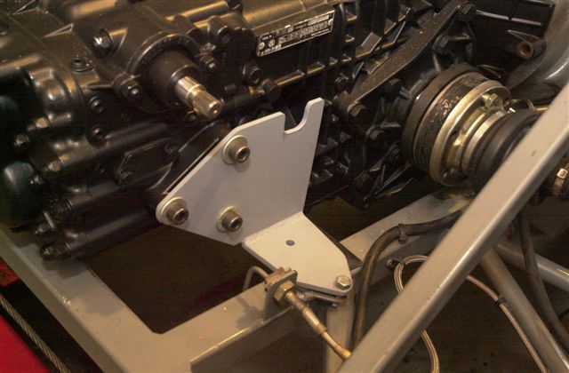

Another shot should anserw some questions. The BMWm1 shiftbox and linkage will be fitted on the Zf-2.Also, I found out the case is made of magnesuim and not alum. Very rear? I don't know! But most are all alum and steel.

The Rf was designed around the Audi box so by keep ng the box right side up was easier and cheaper to switch shifter sides. This way you don't have to do all the internal oil modifications. When the box was reconditioned and upgrade ie safty wire bolts etc.. it solved the problem without having to cut up the frame. It is a much cleaner installation.
