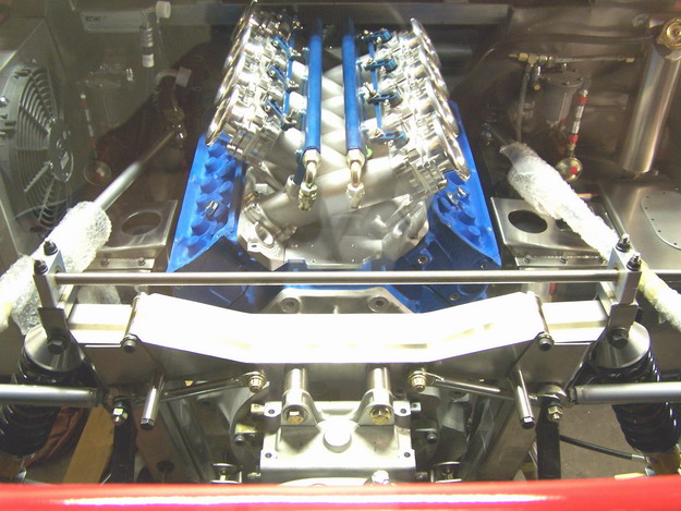

Re: Olivers Ride RF with ZF
I am also using the same manifold. There is still some finish work to be done.

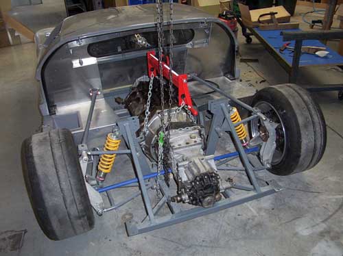

This is the right way up
and this one ZF mounted in Chassis

if you lowerthe engine should you modify the bellhouse?
because the way it is now if i putt the zf horizontel i've got only 4 cm between the bellhouse and the floor of the car

Frank Sorry mate I realize I should have replied to your earlier posted questions.You won't be able to use the Pantera bell housing.My bell housing you can see in the photo is an ERA sourced Item and it has the bottom shaved to be level with the ring gear.It bolts directly to the ZF-2 and allows use of a Standard Ford clutch and flywheel.The ZF can then be mated to a Windsor motor and to set the whole unit low in the chassis you will have to dry sump or get a shallow sump with wings.I can help you with dry sump detail if your still unclear what's required.

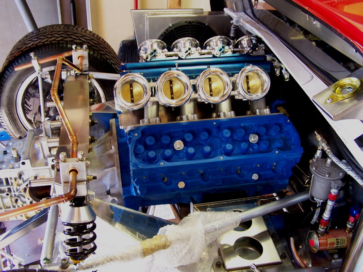

John,
I purchased the manifold from Steven Morrison from S.D.&L.A.Morrison in Melbourne, Australia.
I meet Steven at the SEMA show last November. He made me a deal I couldn't refuse! I will try to attach a pic.
Ken J

Here is another view,

Hi Ken,
Your CAV is sure filling with nice details and looking spectacular.
I also have to say that the straight intakes runners on that manifold
look like a modern engineered system that really means business !
