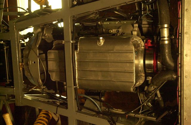

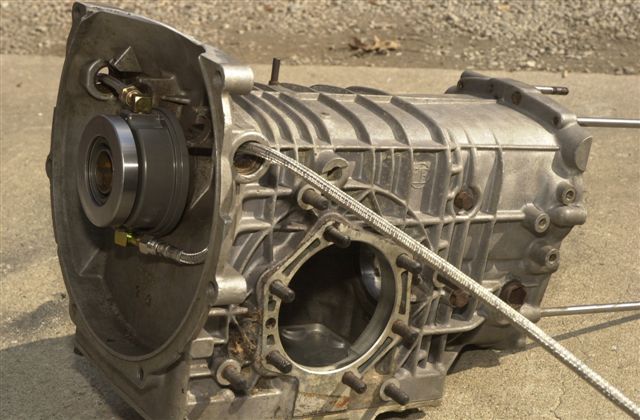

To flip or not to flip??????
Not flip.. Pantera shift patern...simpler install with out the exspensive modifications to the gearbox.

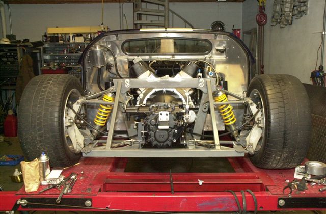

BACK DOOR VIEW

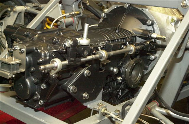

Throwout mockup

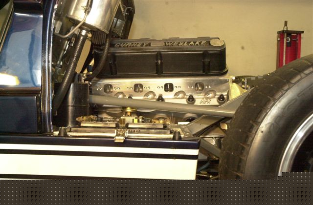

Plant With Frans "RCR" gorgous valve covers

Re: Olivers Ride RF with ZF
Larger Master clutch to handle the larger throwout bearing.
but you've got a different bellhouse then is fitted to the pantera zf
your's is lower
look's smashing
Frank

The bell housing is from Kenedy engineering. It is a very nice piece for $350.00. ERA is around $1000.00 more or less. It is alot lower than the flipped version. This also allowed the engine to be lower in the chasis. The oil pan had to shave a litle more so it would not hang over the chasis. It is a very nice fit.

i've orderd one from john wisher
that one is also very low
but it has to be flipped
i've started already so just got to finish it
Frank

[ QUOTE ]
your's is lower
look's smashing
Frank
[/ QUOTE ]
How can it be lower? The input shaft still has to align with the crankshaft. Correct?
That's what I thought too. Assuming same clutch size it would just give more or less clearance (internally) around the pressure plate.

sorry i mend smaller
if i take a look at his bellhouse and compare it with mine
the radius of mine is larger
