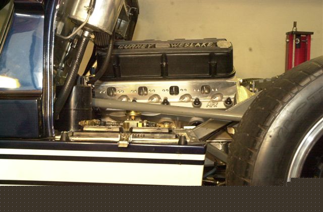

Plant With Frans "RCR" gorgous valve covers

Old 03-20-06, 01:18 PM   #68 (permalink)
