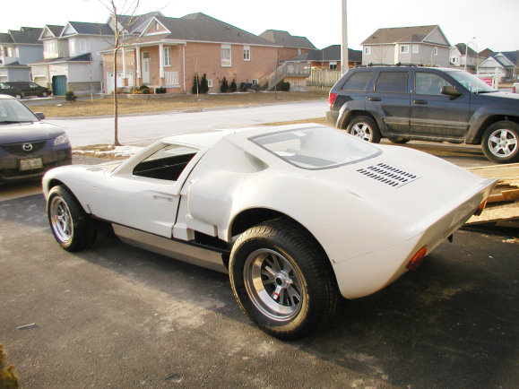

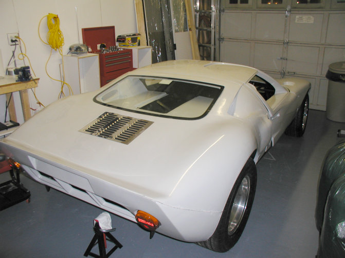

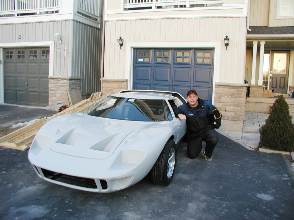

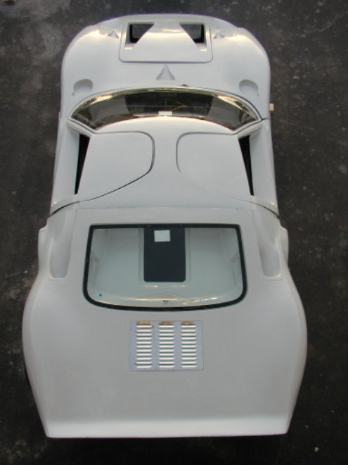

Well, finally got the car on it's wheels today so I thought I would roll the beast outside for some -20°C artic air, man it was a cold wind (as you can see by my frozen eye lids!)
The rear body needs some trimming on the inside mud guard area so that I can close it without it fouling the reverse links, not a big deal (MDA usually do this but we were tight for time to get the car shipped). Fuel tanks trial fitted, sill panels in the garage. The wheels might need a bit of machining for backspace, it's close, so I might need to drop the ride height to get a better idea. No machining was done to the wheels when ordered but Bob at Vintage sent me the maximum material removal specs for the front and rear.

Another-

Re: 1st MDA to Canada
From the balcony
Frozen....

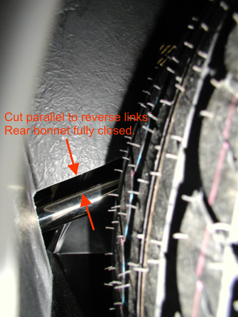

Here ya go Mark -

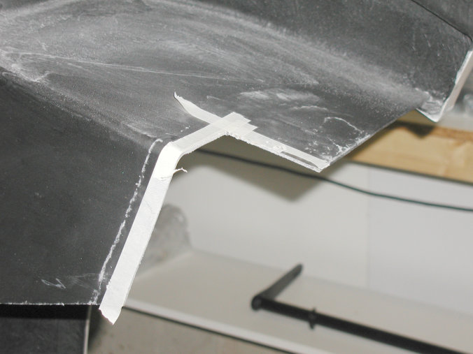

I had to trim the inner mud guards for the rear body to clear the reverse links. I lowered it until it made contact and marked off the area to be trimmed. Jigsaw worked fine and it now can close without effort.
Chris

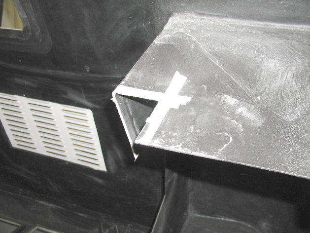

Mud 3

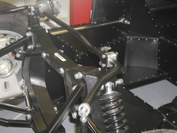

Rear anti-sway bar installed. They'll need to be taken off later for engine/trans installation.
Next up is the steering system.

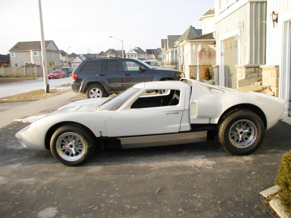

Starting to look like a 40 - gotta love the rear on these cars!
Chris

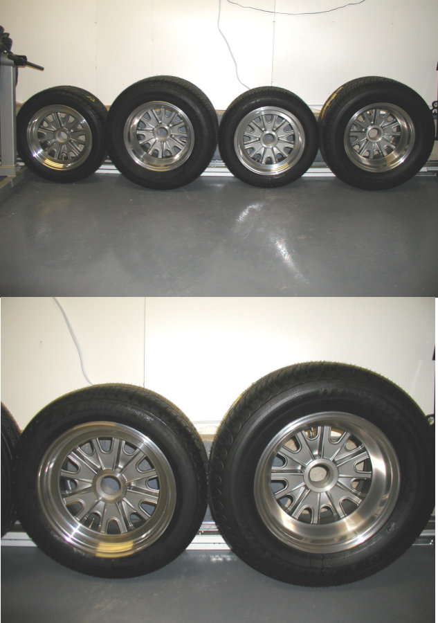

Hi Chris,
I went with 6-pin (for 6-pin MDA hubs) Halibrand Vintage Wheels @ 7.5 inch front and 9.5 inch rear. I can't get the tyres (ha) in Canada so I had to order them from The Tire Rack (great service). Front's are 225/50/15 Dunlop Qualifier T (T-speed rating) and 295/50/15 rear. Everything fits beneathe the wheel arch and has a nice beefy look.

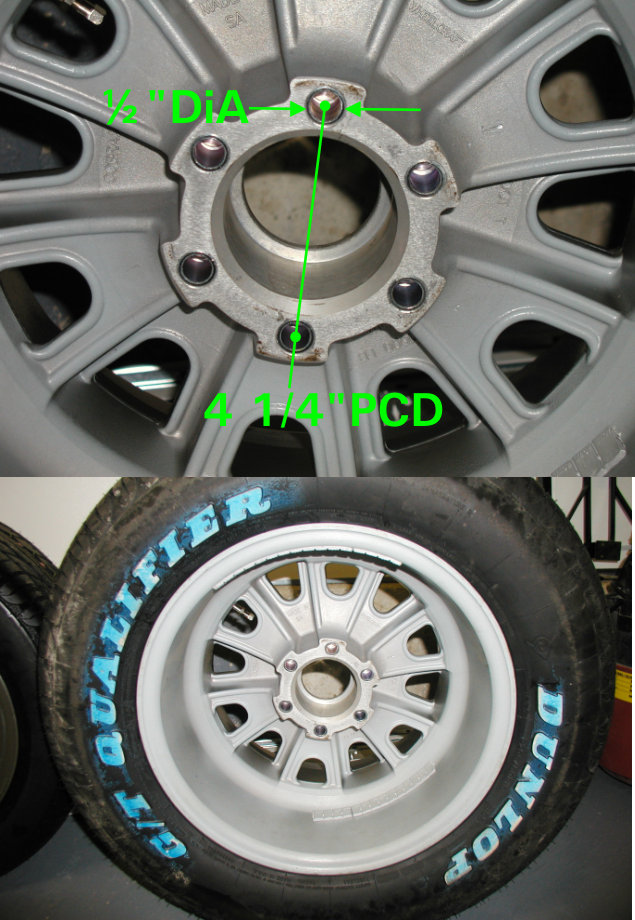

Hi Mark - I know this should be posted in the Items for Sale Forum but I'll sneak a plug in here-
To be completely honest, I really don't know what wheel type I want just yet. With that said, I might as well sell these and free up some of that money and invest into other areas of the car right now so I can get it more up to speed for Carlisle in May. I can buy wheels at anytime, they just don't serve a purpose yet. It is a beautiful wheels/tire combo that I will definately conside next time.

Technical-
